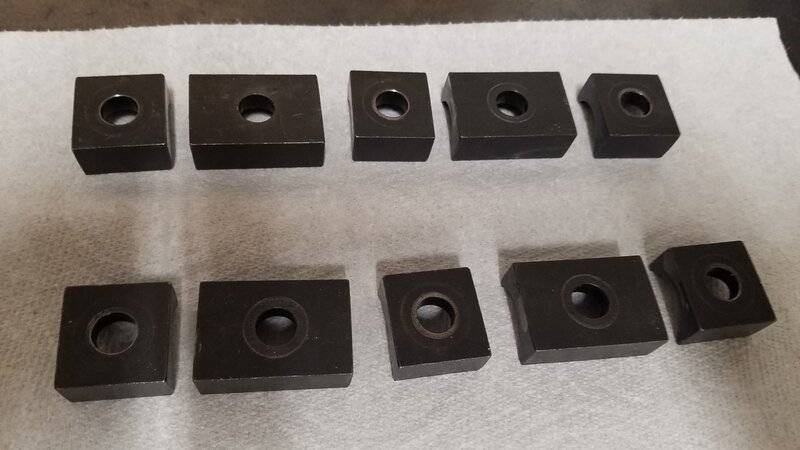

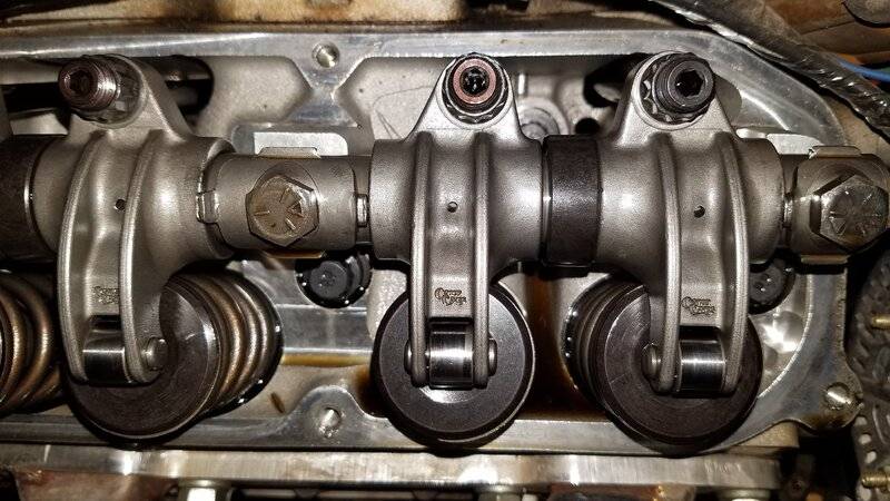

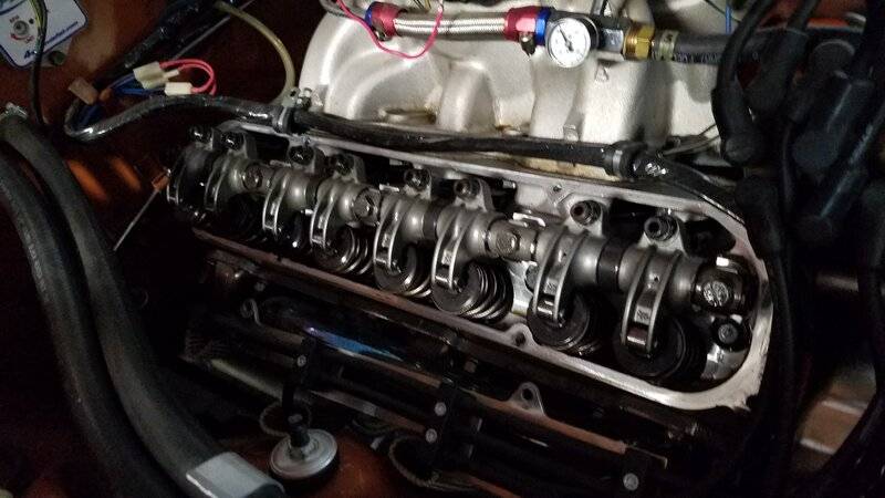

Post a pic so we can see what you have.
Here are the pics
Post a picture of the oil baffles inside your valve covers, especially the one below the fill neck on the left side. It may not be clearing the push rod adjusters and will sound like a bag of ball bearings if you don't cut a hole(s) for clearance. I don't remember the brand of rocker I used but the issue was very clear when you see the dents in the baffle.

You need to change those hold downs to get rid of the space and use shims. Do the comp rollers have specific hold downs that should be used? I dont know of any aftermarket rollers that can use the stock hold downs without issues or being shimmmmmmmed to death.
I dont know if there are specific hold downs or not but if not do I just pick up what ever Mancini, Summit, or 440source have?
I wouldnt just grab any set. Contact comp and see what the recommend. Someone on here has probably used those before that can advise what works best as well. I only use harland sharp. I get all of their hold downs and a couple sets of shims and spacers. Its always a tedious task of measuring and lining everything up and I need different size shims/spacers depending on heads/engine.

1) you don't need new hold downs.
2) your clearances are acceptable
3) you can get/add shims to tighten up the clearance, if you like.
I'd use the hold downs like Hughes or 440 Source. The contact area of the stock style is small & can cause wear. The process of shimming is tedious, but attention to detail pays off.

Man....035 is loose especially for steel rockers. Most guys, myself included shoot for .015-.020 side clearance per pair and that's with aluminum arms which grow and tighten the clearance more than steel or iron. I'd set them at .015, run it up to temp and see if it's any quieter. After they're good and hot, check a few pairs immediately after shutdown and see what you have, and verify they didn't get too tight at operating temp.
@eagleone1983 I have some Comp hold-downs out in the parts stash that have very little use. They're yours free if you want them, you'd just have to get the proper bolts. If you're interested just PM me an address to send them to..
Been running 0.012" - 0.015" per pair with stainless rockers for years, no problem.

I noticed the roller rockers have quite a bit of side to side movement, over .035" worth (that's the largest feeler gauge size I had) but it's pretty close to being that measurement.
Looking at some Comp info for your other thread, Comp says a minimum of 0.030" for side clearance. Again, you can run less, but what you have is not a problem.
