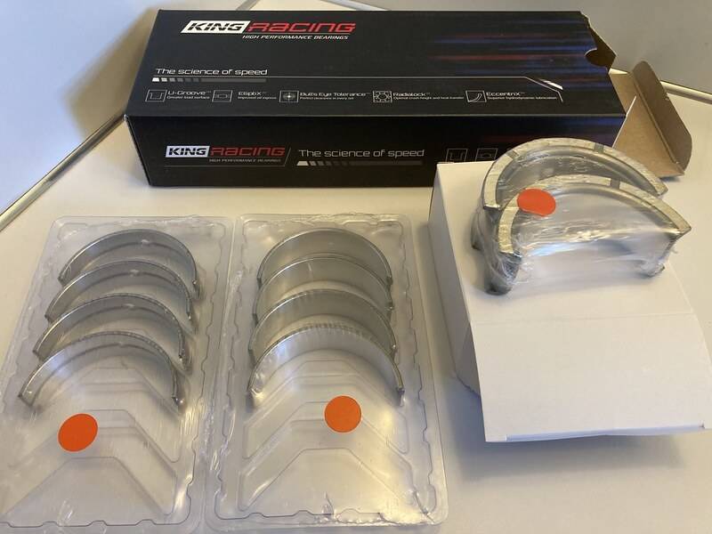

Although the 440 can produce decent cold or hot pressure, if I could do it over again I would have used half grooved mains vs full groove Clevite 77's. Didn't like the op with the standard volume pump, switched to a HV Melling and it's fine.Full groove does cost some oil pressure
and the two half grooves cannot carry the lode of a full width bearing
(each side of the bearing has a curve off of load ability near the 4 edges)
a big loss is oil to the top of the bearing
Why ford went to a Side Oilier
and why we grooved the block and side oiled at the parting line where there is some
eccentricity to get a good "oil wedge" for the hydrodynamic lubrication
Remember it takes good oil flow to take heat out of the bearings
so it's a balancing act between clearance and flow/ pressure
there are also od grooved cam bearings or we have a tool to groove the blocks so we can feed the cam somewhere around 3 oclock
The usual diagrams are for an inline engine where they show feed at around 4 o'clock
V8 has two higher pressure zones and they oscillate
cam moves all over the place

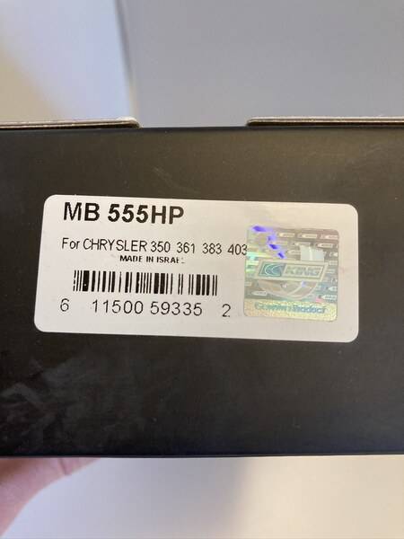

What about standard - half groove versus 3/4 groove versus full groove main bearings and there effect on oil flow resistance and oil pressure
Us 383 guys are limited on main bearings
