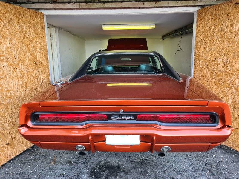

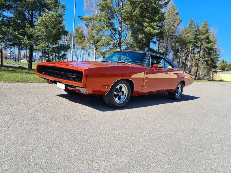

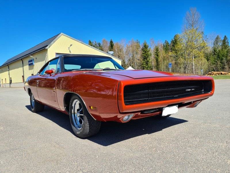

So what brand of oil do you use in you engines? I use the Joe Gibbs DRIVEN HR-2 High Zinc 10W-30 and it seems to be good. What do y'all think? Just some pics of my love to enjoy while we discuss this =P
