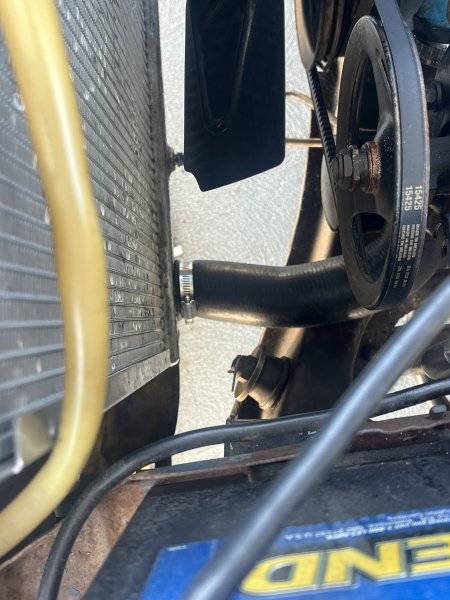

So i filled the overflow up and i pulled over just now and it was steaming out the overflow hose! Theres nothing in the container anymore! And heres the pic of the hose that burst that we replaced last night(big black one)
Lower hose can blow if the thermostat is stuck shut.
Allow to cool and put a new thermostat in it.
