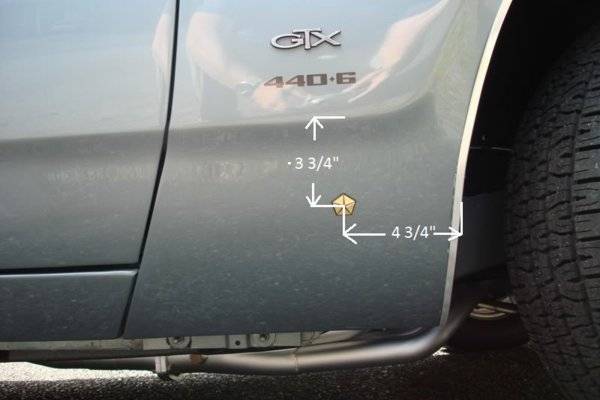

exactly where the pentastar goes on guards . like it says where does it go ? I have two of them to be fitted ,but need exact measurements for a 1971 roadrunner and 1971 r/t charger ( missing on both of them )
I don't have any exact measurements, but if they were filled you can find where. Take the right inner fender shield out and look for some bondo sticking thru the holes or evidence of welding.
Here ya go, and there was only one on the right fender. I got this from another trusted member here.
Hey wait, wouldn’t that pentastar go on the left guard/wing/fender since you drive on the right? :steering:
Just kidding. :p
