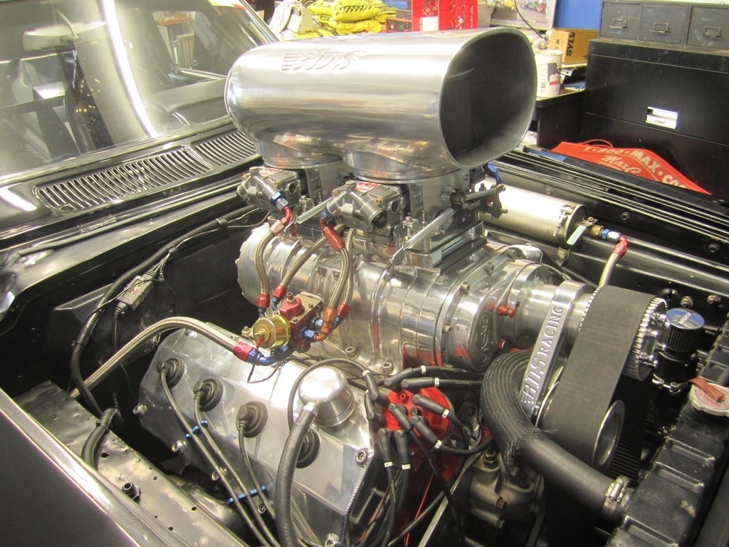

I have had Moroso Wires,Accell,MSD and the like.BEST wires I have ever had are the FIRECORE 50 wires.They also make distributors.http://www.firecore50.com/ ,tell them HEMI_ITIS sent ya!
Ok so I just put brand new MSD wires in and a new blaster coil. How do I test wires to be certain they are good? ohms on the multimeter? How about the coil? How do I test that?
Yes,the only way to test the wires is with the ohm meter.
And the coil,,,,,,wet your fingers,,,,hold the wire and have someone video you while you hold that wire and put the vid up here.We can then tell you you if the coil it good.:rofl:

The culprit! A Sparkplug wire that wasn't plugged all the way on! I have long bendy like boots on the wires, it was on there but no clicky! Pushed good and hard and it went click, and I went screeeeee!
Ha great idea! I'll do just that! Just discovered the plug wire wasn't all the way on. I have the long bendy boot style plugs from MSD, it was on there but not clicked on, so that fixed it! Holy crap your blown HEMI is awesome!!!
That "no clicky" thing on plug wires has gotten me more than once
