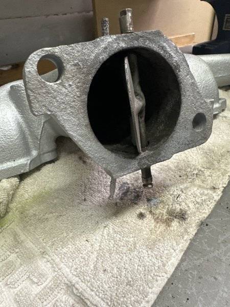

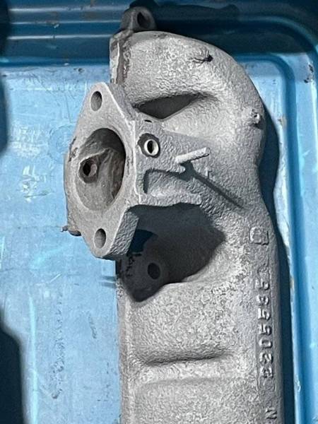

As shown in the picture the valve and all the parts are gone. Is tapping threads for plugs a good solution?
I think most people weld them up.
Both of those methods are what I’ve heard is good. Since I don’t really weld I was thinking the Allen plugs would work. Thanks for the replies @#41 and @4vnut

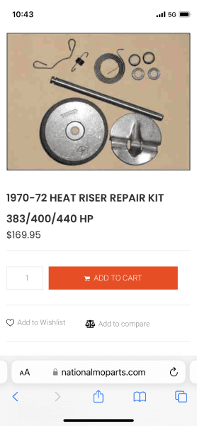

complete rebuild/replace kits are available. Prices are from: Okay!... to Really?
I know those are hard to come by now a days. I thought a little bit about it but don’t think their needed.
So, on my first try, I did find brass plugs, 1/4” NC, to fit the brass sleeves. I started tapping the one side of the exhaust manifold through the brass sleeve and on one of the last turns with the tap the brass sleeve spun out. Ooops! I removed the other brass sleeve, as some folks here told me to do, and tapped a 7/16th” NC tap through the holes but then couldn’t find plugs in that size. I could have used shortened bolts but I felt like the tap didn’t cut deep enough.
I asked around some shops about welding it up and was told that cast iron is special and needs to be heated in gradually increased higher temperatures, then welded, then cooled slowly in cycles.
Another fellow said tig welding has special rods to weld it and the cast iron only needs localized heating.
Well he also had 1/4” pipe thread plugs so that is what we used to seal those, now pesky, holes. I coated the manifolds with Slip Plate and will post a photo in a few days.
Thanks for all of the advice.
I've welded cracked manifolds on a table and mounted on the car. I use a 3/32 308 stainless rod. On the table, I heat the manifold to (it's been a while, so 400 degrees?) make the weld and either put it back in the oven or wrap it with asbestos blanket and bury in the garden (if the old lady is watching. She doesn't like non-food stuff in her oven).
Yours is plugging a hole, so the cooling isn't as critical as a crack. What gets us in trouble is the differing contraction rates of cast and stainless as the weld cools.

I will probably buy the kit. I could then just reuse the valve and pin as is or install the full kit.How do you remove the pin? Just press or hammer it out?
Truth be told, I never removed a heat riser valve. I do know there are sleeves that the shaft rotates in. It looks like the kit may not supply those. Hopefully someone else can give you guidance. I think that shaft is just punched out.
You need to grind the welds that attach the shaft to the butterfly valve. This will release the shaft so that it can slide out.
The new valve will need to be welded to the new shaft.
More detail in this thread:
