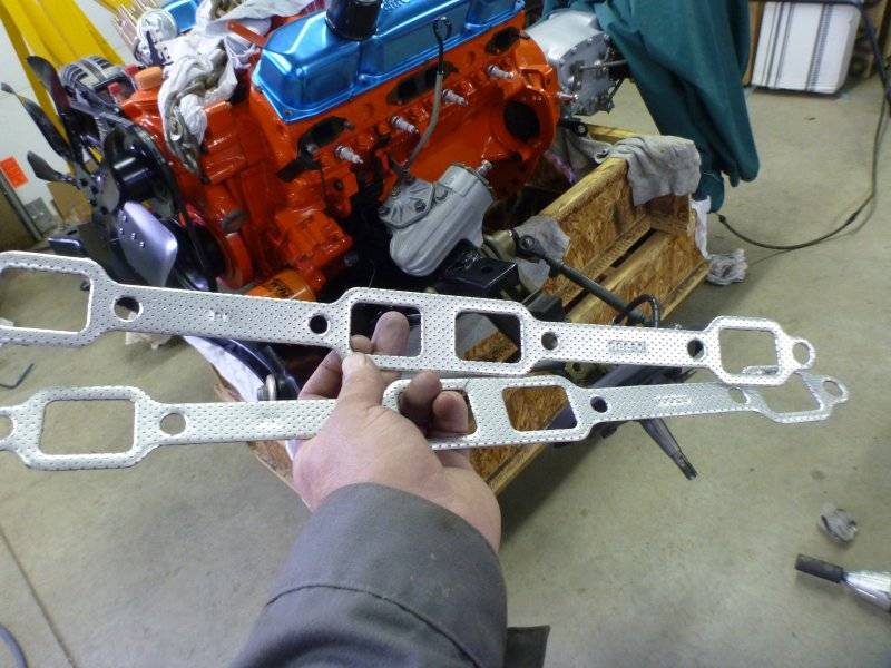

I know they did not have a gasket from the factory.
But,
The gaskets i have are way too big in the port area. There would only be a tiny area of gasket between the flange and the head surface.
These came with the complete kit i bought from 440 source.
What are you guys using for gaskets?
Worked at Mopar back then, never used any, resurfaced exhaust manifold if pitted up. Had to remove a lot of someones gasket that were leaking!!
