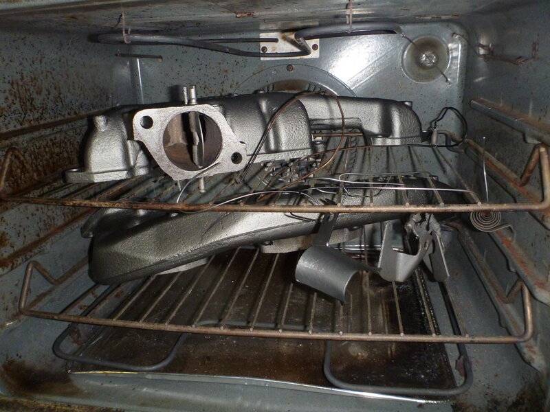

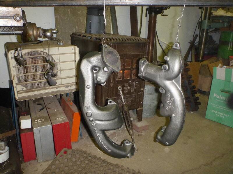

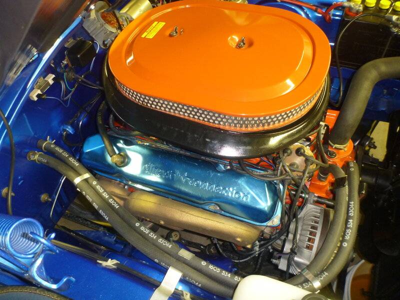

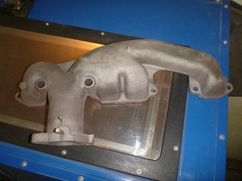

Blast'm, prime and coat with VHT cast iron paint and bake properly. No need to pay someone to do so..
And over a 1000 miles later..

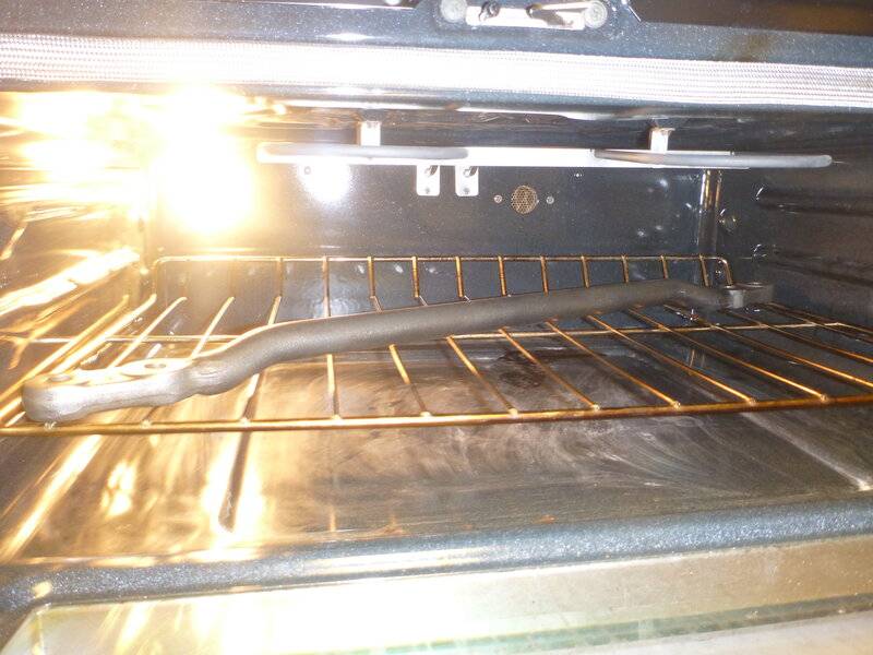

You forgot to add if you are going to use the wife's oven, do it when she's on a weekend trip and open all the windows in the house haha! I have also had good luck with Factory Manifold Gray by POR15.
I don't have (or want) a wife. Anyone inclined to take your advice should know once used car parts are baked in your kitchen oven, it effectively poisons it for use on food. Using it to bake on chemicals like paint or powder is inviting future health issues from contamination and hazardous fumes, even if open all the windows.
Some ceramic high temp coatings dry in the open air and fully cure later through engine heat after installation. Only a few require tumbling (i.e., chrome replicas). None should be done in a home oven. Ever.
They wouldn't bake while engine is running ?
They might, but you'd probably burn off fresh paint. It's manifold paint and directions are on the can... it's a stepped cycle over time while raising the temperature. The last one being 600F if I remember correctly.

Sandblast, wipe down with lacquer thinner, prime with a Hi-temp primer made by Xtreme. They also have the cast iron colored Hi-temp paint, best to put on at least two coats. Paint will cure when engine is started, no need to bake in oven. Paint is available in pints or rattle cans. Be sure to use in a well vented area. Google Xtreme Coatings.
Yes that’s what I used and it is an amazing product! As said blast manifolds paint let dry and start engine and leave the area, leave on fast idle for a great baking job !

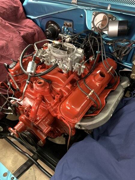

For what it is worth, I used, like above the VHT Cast Iron Paint. It does require a step process of heat as it outlined on the can and on the site. I used an old propane BBQ to get mine up to temp. They look great after say 250 miles. To prep, I blasted them in the media blaster, cleaned them with solvent and then applied the VHT direct. So far, So good. Best, B.

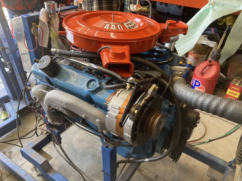

New Hooker Comps, blasted and painted with VHT header paint. Just fired up last week, looks great. A bit more work but much cheaper than coated headers. Little bit of oil dripped on the flange under a valve cover bolt, cooked off and is gone.
