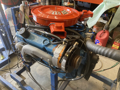

I have had great luck with the VHT flame proof paints on the headers of my Model A and the manifolds on my 340 GTS.
I have used black on headers for 12 plus years, never flaked off at all. Some discoloration because the headers are exposed to the UV sun light is my thought. As for the GTS, I used the cast iron flame proof when doing the motor this past year.
Went on great and has held up great. The first manifold shot shows someone’s touch up that we fixed.
