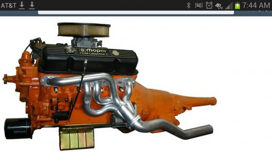

2014-10-15-07-44-17.jpgTti has shorty headers and they offer 2 pieces of pipe that adapt it to there exhaust system
