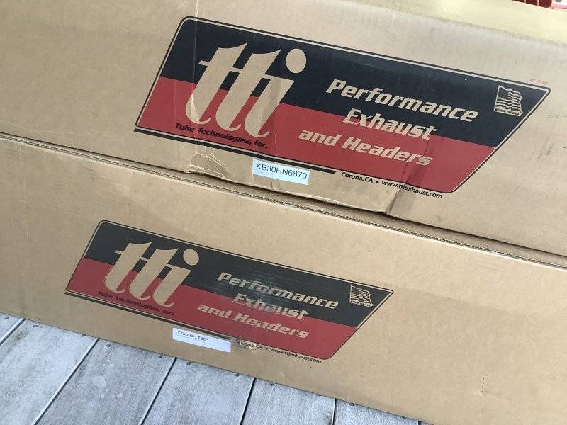

I’ve never been accused of being cool, but these and a pair of “I hate my neighbors” 3” Flowmasters will be going on the GTX in the near future…
