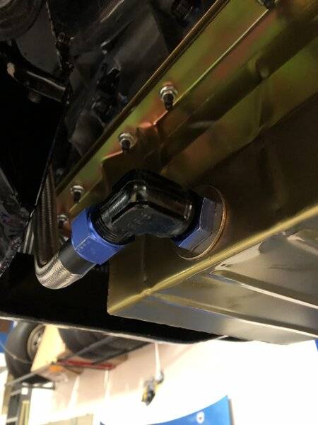

What are you using to seal the pickup to the oil pan?
The one I am going to be using on my 426 has sealing rings, they are a nylon type material.

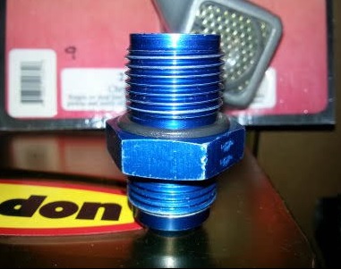

I take a -12 fitting and machine a groove to capture half an o-ring. Tighten fitting into pick-up and O-ring seals to outside of pan. No sealer, no leaks.

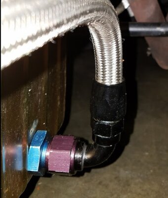

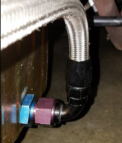

I have the dual line with my external oil lines. I am using the crush washers that came with the kit. So far so good, no leaks and it's been together several seasons now.
