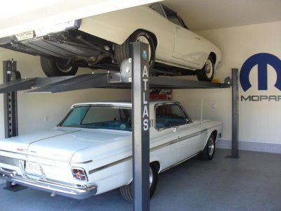

One of the FBBO members recommended the Atlas lift to Me and I'm not sorry I bought it. Drove to Newark De.and bought it at Greg Smith, had it installed and never a bit of problem with it. SAM_2598.jpg
