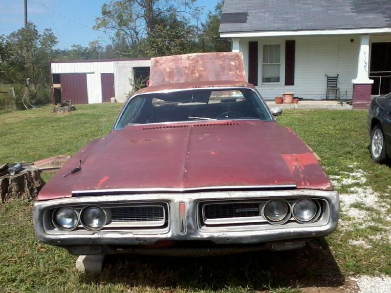

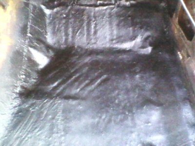

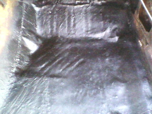

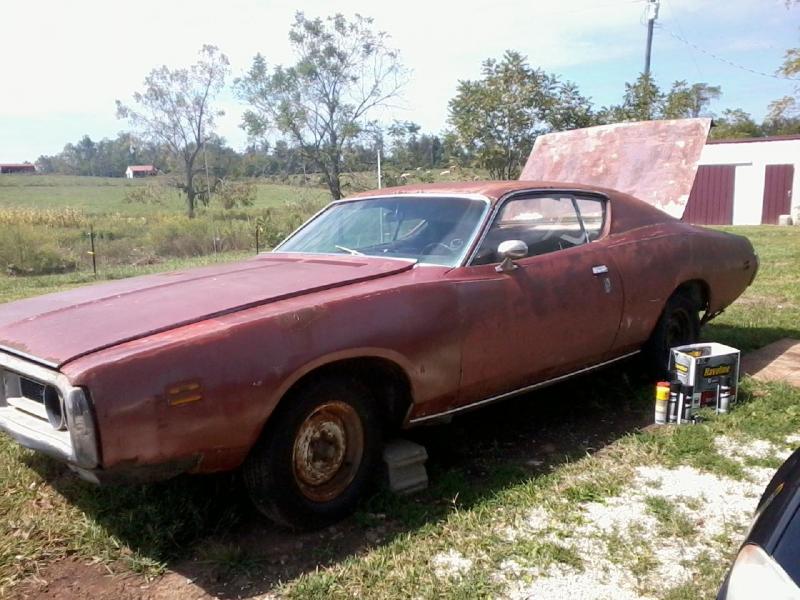

Let's see some pics ,anything is possible with enough time and a proper budget.
These are some pics of not long before I put it in the work shop to start on it. The rockers and frame have already had new metal welded in so that's a plus. As far as engine parts go I already have a new cam and lifter set, valve springs, oil pump, and timing chain set from a previous project. As far as the windshield... I found a local place that can have me one in 2 days for 117 bucks if we install it. And Dad has already switched his off days to coincide with mine to lend a hand...benefits of being self employed. It'll be rough but we're gonna give it hell.

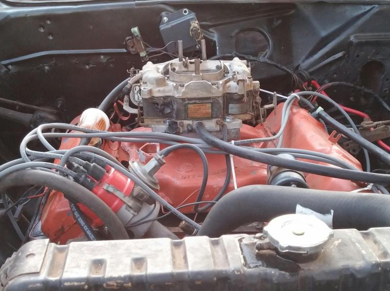

Well yesterday I scored a complete 400 4bbl engine for 200 bucks. Suppose to have ran good when it was pulled. Best I can tell its a 1977 model. I pulled a valve cover and it was very clean inside and has 452 heads. Already have my gasket kit to inspect and reseal everything as well as a new oil pump and timing set I already had. Gonna get her cleaned and painted this weekend...I hope. Pics to come when I get back down to dad's Sunday. Hopefully it'll save me a few hundred dollars to put be able to put a little more money toward other areas now in my ultra cheap Charger rehab.
Nice score, 400's are a great motor! The Charger looks pretty solid, good luck with the build.

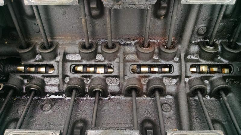

After getting the heads and intake off. I'm guessing the engine is low mileage because almost no cylinder ridge at and still seeing the cross hatch.
