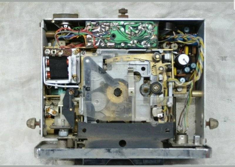

Hello everyone I am looking for a internal diagram/ schematic. The unit is a 1971-1973 console mounted player recorder. Philips 3501-045. Is there anyone here who can help a guy out? I need to find part's.
By the look of the picture, you are at least looking for a belt. It looks like it has turned to tar, which happens when they get old and are not used. Even with no belt to work with, there are places on the internet where belts can be replaced by size. Here is a site you can try: https://www.vintage-electronics.net/

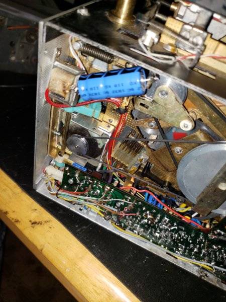

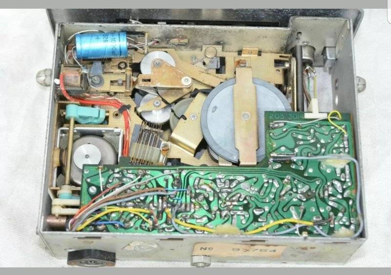

Thank you. I pictures are for reference. The one I have I replaced the idle tires and drive belts. It does work , but poorly. The Fast forward doesn't work and the reverse is intermittent. I bought a book from Ebay hoping it would have the schematic for the tape player, but it only has the multiplex reciever.
I cleaned the pullies and demagnetized the head too. I noticed that the take up reel has a larger sized tire on it that makes poor contact. That seems to me to be the problem with the fast forward at least. But I'm having difficulty finding out the size. I used my digital caliper to measure the old tire. And contacted the source that I had gotten the belt and tire kit from. I really would like a manual on this unit. I'm a noob and not sure what to grease or where.

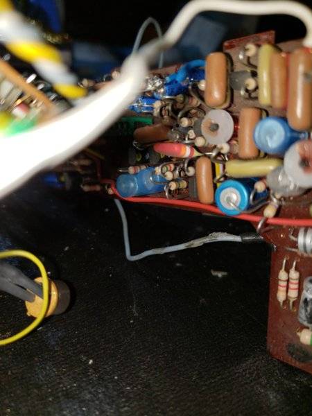

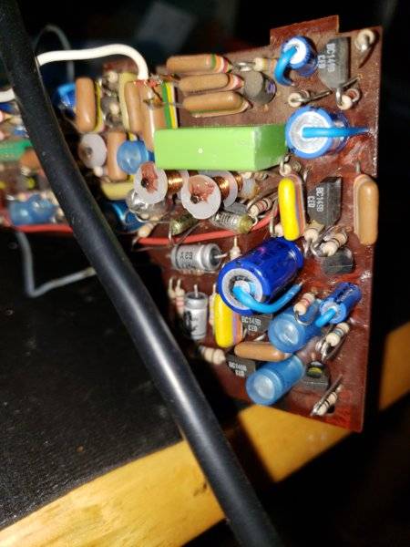

I am waiting on another part to complete all the rubber parts restoration, ie. Belts and idle tires. Next I'm going to replace all of the electrolytic capacitors in both the reciever and the cassette player.

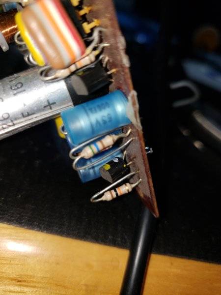

If you are looking to recap your recorder and receiver it's going to be around $100 for the capacitors. They are all axial capacitors and they are difficult to source do to the oddball ratings.
I ended up getting mostly vishay branded caps.

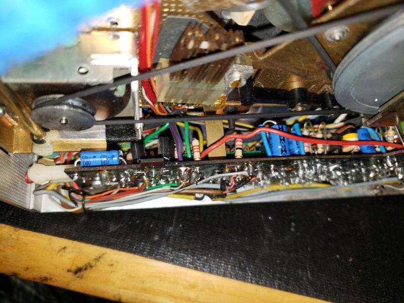

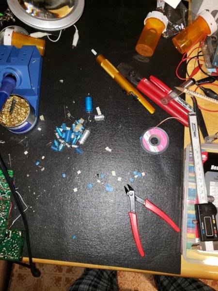

I changed out the electrolytic capacitors last night. It will be going back together this afternoon. And then I will tear into the multiplex reciever and change out those electrolytic also.
All changed out.
In hind sight, it would've been cheaper to get all radial caps instead of the axial ones. But oh well.

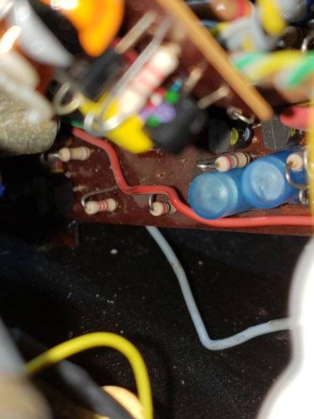

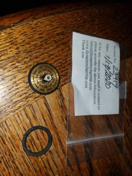

Today I received the tire so that the fast forward will work. If anyone is interested this is where the tire came from and where it goes. The new one is installed, the old one is on the right.
