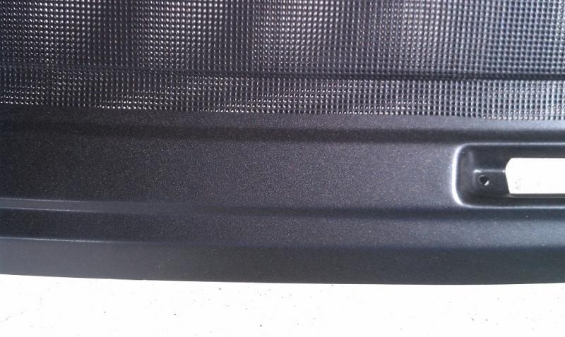

This is true yes, the ingredients are not available anymore, however, the link I posted from the company above, he still has a limited quantity of the ingredients, as he got them in his inventory when he bought the PPG paint store he now owns, that is why it is still available from him until he runs out. I used it on my 73 RR dash, black, and it looks awesome. Now you will have to find someone that knows how to spray lacquer otherwise it will come out with too much texture and be like sand paper.
Also, keep in mind you might be able to find other paints that have the proper texture but they will not look right. The original dash paints are not just a basic trim black, they also have a super fine silver flake in them and you will notice this when the sun hits them.
Here is a close-up of the speaker/vent cover on the top of my dash, you can see the flake in the paint. In the shade, yes it looks like just basic trim black, but in the sun, it looks silky. I think this is what really sets MOPAR dashes apart from all others!
