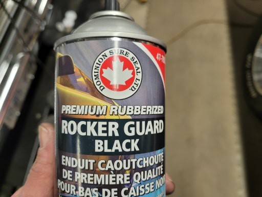

I used Dominion Sure Seal Undercoating, and am happy with it.

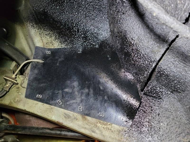

This matches damn close to the OE stuff in my '66's wheel wells. Not sure that you'd get it thick enough to simulate full J55 undercoat though.
