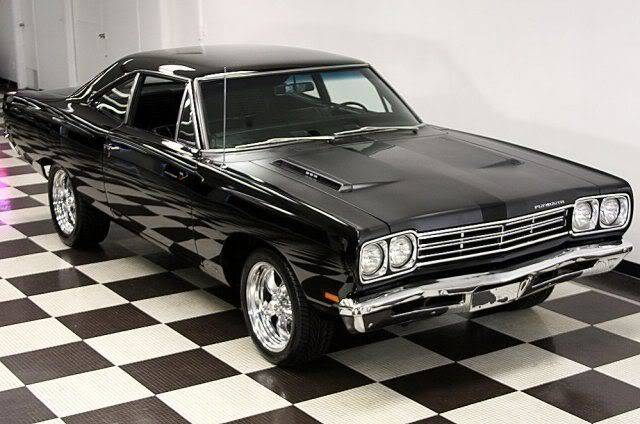

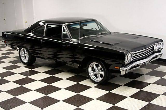

A little something for inspiration.
Wow, that is indeed inspiration, Black on Black on Flat Black looks wicked!
Yes sir it is!! Thanks for the pic's Dave..Those are awesome!!! I was stirring on the idea about hood stripes Matt, but after seeing this car, they will definitely be making their way to my hood.
Wow!
OMG...is there an angle a clean RR doesn't look good from?
Thats just beautiful.

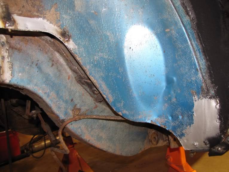

Boring work tonight.....Removing undercoating. By far the best thing i've found for removing the stuff is a decent air needle scaler. After just a couple hours, all of the outside inner fenders, both back inner wheelhouses and a portion of the rear floor pan are stripped of all undercoating. Being most of the underside of the car is new, another hour or two and she will be clean of all factory undercoating..

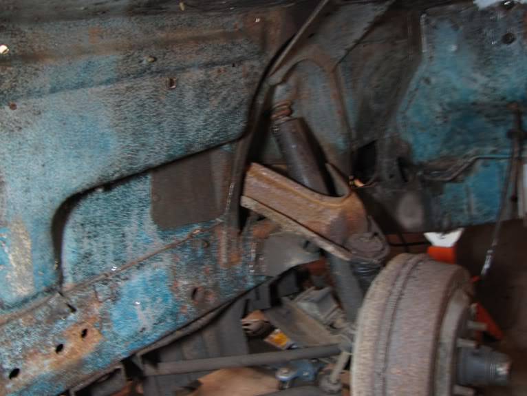

Here's a good pic for the undercoating critic's. Fresh looking clean paint that was hiding underneath the undercoating. Show's just how well this stuff protected these old cars up here. If she didn't have this undercoating from the factory, the car probably would have been rusted to pieces and crushed a long time ago..
I'm impressed.... Again lol!!
Not too many of my friends know what a needle scaler is let alone to own one lol!!
I have plenty of undercoating on my old bird too and I agree, it's saved these northern cars from turning into an orange stain in the dirt.

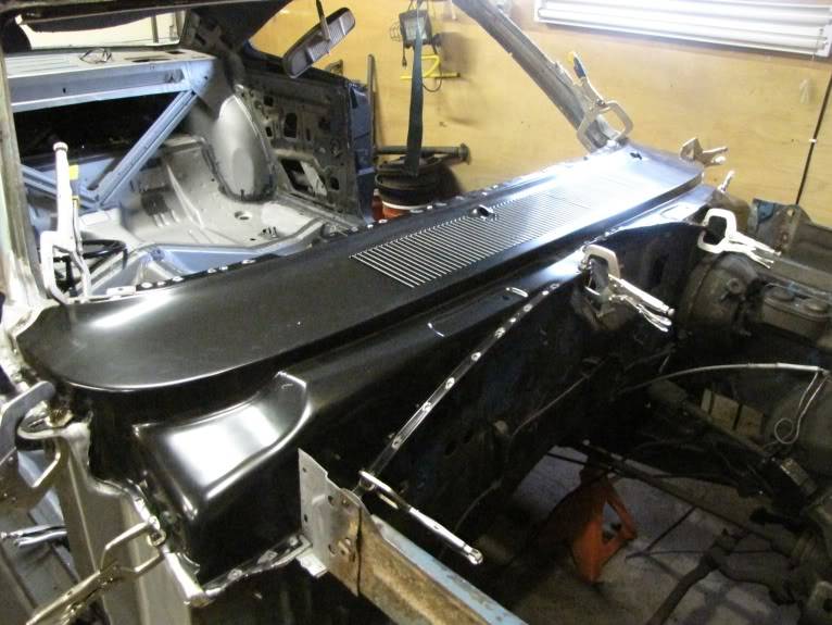

Ah well, got a chance yesterday and tonight to fire up the snowmobile once again and go tear up the back 40..In between all that I found some time to peg away at the roadrunner..

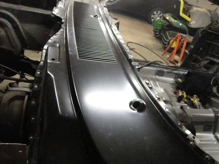

Got the cowl drilled, fitted and for the most part welded on.
-Nice Black RR-
-Holy crap you got snow again...gah
-That cowl looks great prop
