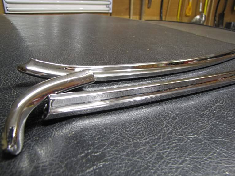

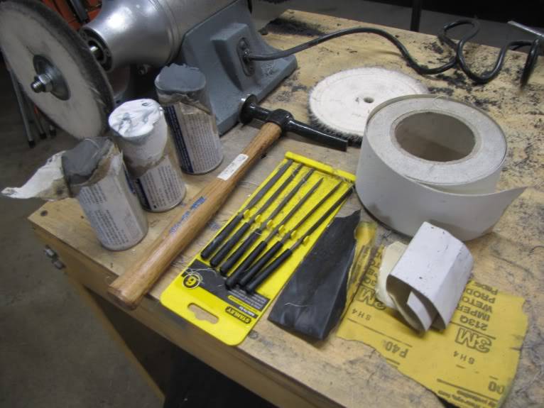

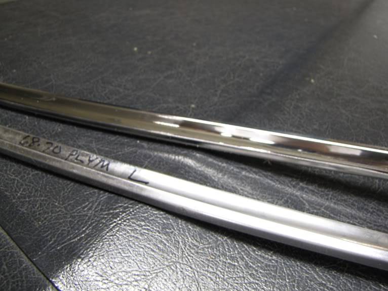

As far as the paint Dave; Spent some time filing door edges straight for a couple days last week. Tonight after work i'll be doing some filing and dolly/hammer work on several roof dents. Starting the Stainless polishing tonight as well. I'm shooting for skim coat by either the end of this week or early next. I tossed on a guide coat and blocked to get an overall idea of the bodys condition and it looks like I can get away with only having to skim the quarters, bottom of the doors and the roof. The rest of the car, i'm thinking a 2K high build, block down and see where I sit from there.
One thing is for certain, the PPG Epoxy I sprayed in the engine bay back a month ago is tough as nails. "non sandable" is not the right word for it.. Maybe "two pump chump"...LOL Couple swipes and the paper is headed for the garbage can.
