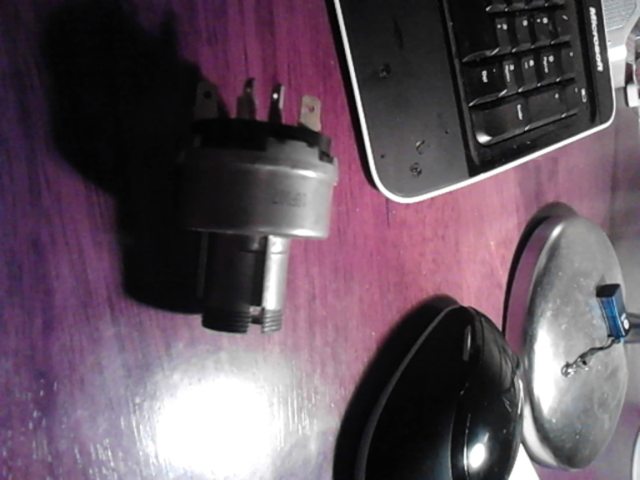

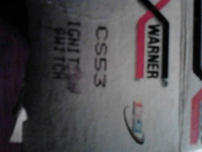

mine is just the switch but it was cheap from the parts store oriellys here local borg warner part number CS 53 if you just need the switch ???

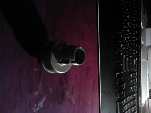

So how does the ignition lock come out of the switch?
Pretty sure the tumblers in the lock is shot or close to it Stu. You put the key in and it's really loose as well as the key is able to move around up and down when it's engaged in the lock........
I had no idea you could pick up the switch at a local parts store.
IIRC ('68 though) if you unscrew the bezel from the front, the switch and lock come out of the back as one piece and it just slides out of the switch.
ill go to the garage and see if i still have the set and see if i can remember how i pieced it together.
Stirred not Shaken...this time!

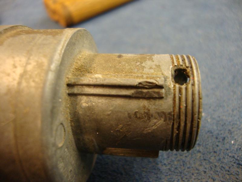

Will, so my voyage out to the garage stirred my memory....it's just like i thought in the earlier post. unscrew the bezel (or screw in your case. lol) and the tumbler sits in the switch. there is a little hole in the threads where a dickie from the tumbler pops out and locks into the hole. (see pic)
i took a look at #11 and #14 on yearone, and it seems to be just about the same design, xcept the 69's assy looks to be a little longer. im assuming the same principle though.

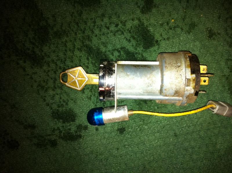

Hey Prop....sorry to keep you hanging, but I've got good news. I have a 69 switch direct from the dash with key and the ignition light and some date code correct Ohio dust. It should clean up OK, but the ring has seen better days.
It looks like you've had plenty of help in the interim....everyone wants to see you get this car back on the road. I'll pm you to work out the details.

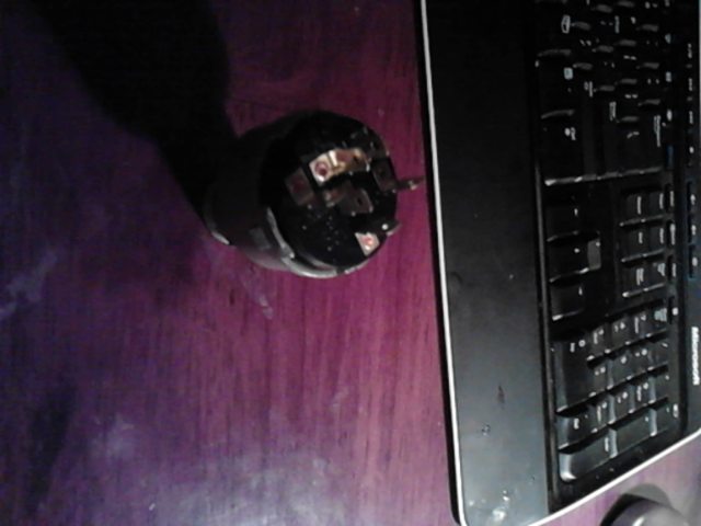

hey will good to see you get the dash together.looks great. I know this is a little late but maybe it might help some one else in a pinch.I did use a ignition switch from a mid 70"s dodge van, the wire harness plugs right into it and fits in the ignition hole on the dash. i still have the one i took off my van just in case.

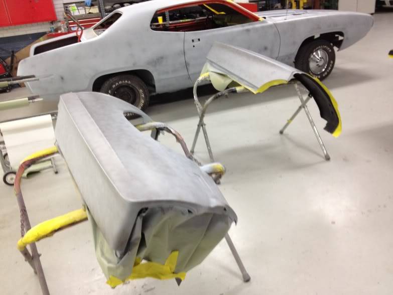

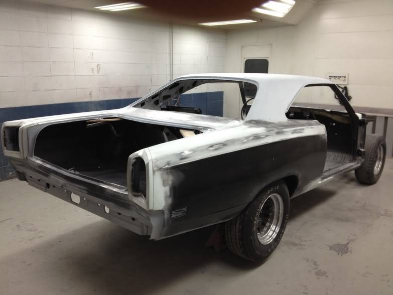

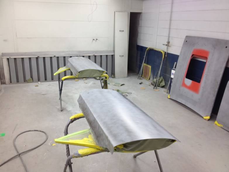

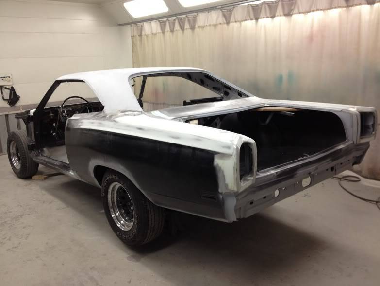

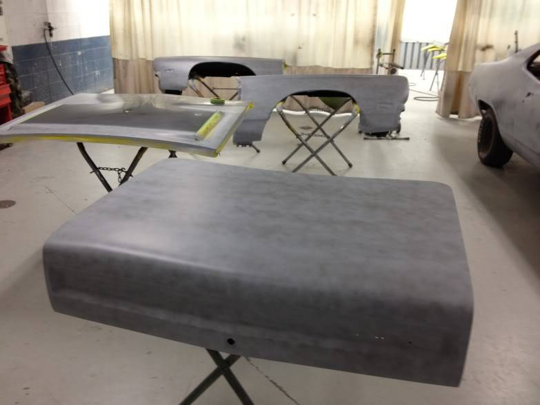

Well been off for the past few days and have had a lot of time to pluck away on the roadrunner...The doors, fenders, hood and trunk lid are pretty much done. I have one more guide coat to block out yet but I think after that, any other leveling will be taken care of by the paint and then wet sanding. I still have to bottom 2/3 of the quarters to skim and block..7 1/2 feet of vertical fun.
Figured I mention the 71' GTX in the pic's. Guy who owns it, bought it himself brand new in 1971. It is a factory 4spd, air grabber car with the hemi orange paint, original everything including the 440. The car has 54,000 miles on it. Pretty neat huh!
