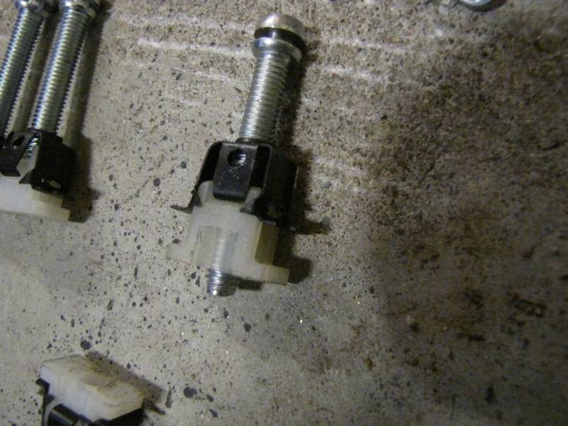

Here's the box nut/fastener that pops into the front of the fender for the headlight bucket mounting. On the metal portion of the fastener there are teeth that must be popped past the opening to lock in to place. I do not know if it is the fastener that is offsized and the fender is right or the fenders holes are too small, but they do not fit without modification.
Hole for the fastener in the fender before modification .470 length wise. Trying to pop then in using the butt side of a hammer handle, I could see the entire headlight bucket face begin to bend in. So, used a small flat precision file and opened the opening up. Came up with a magic measurement of .520 Still enough to hold, wide enough to pop them in.

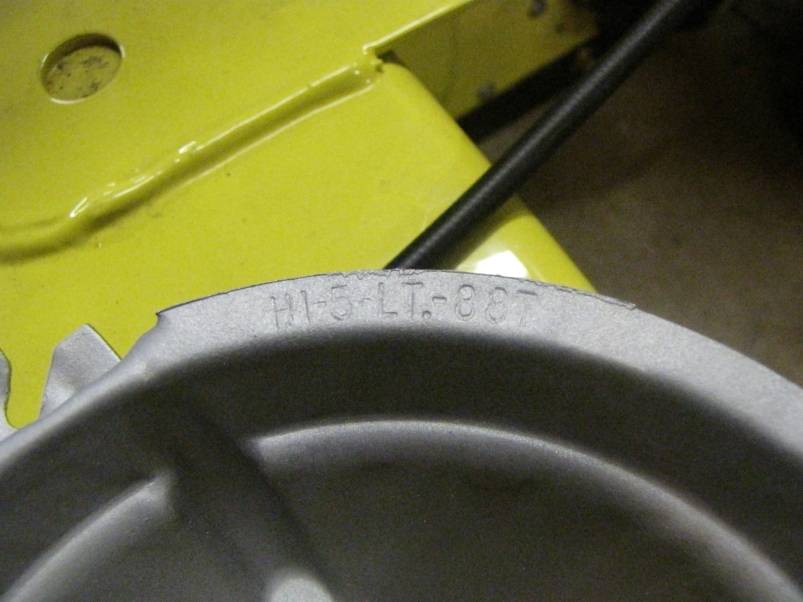

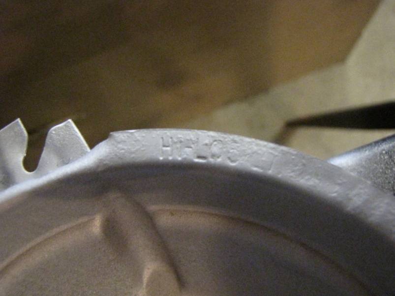

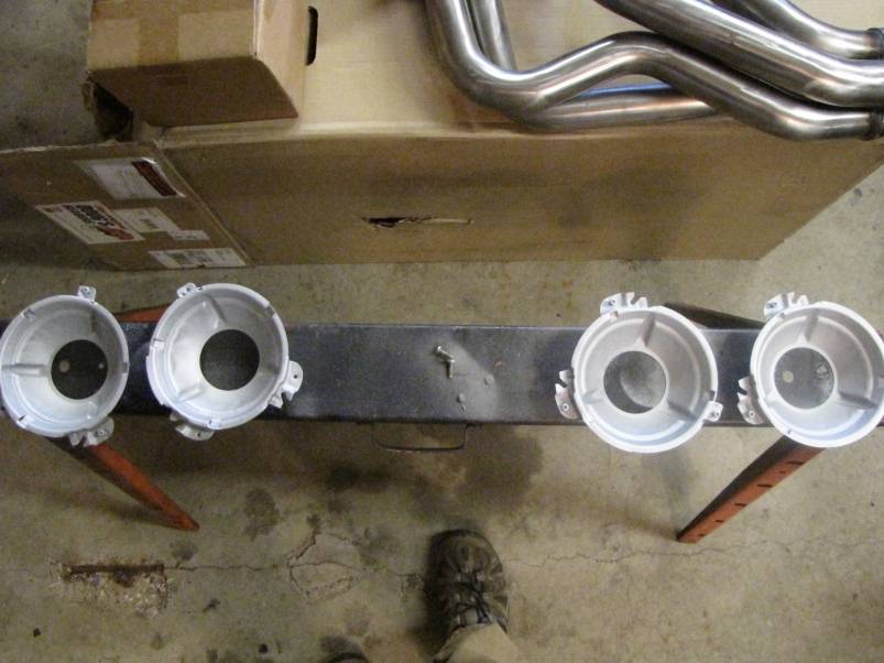

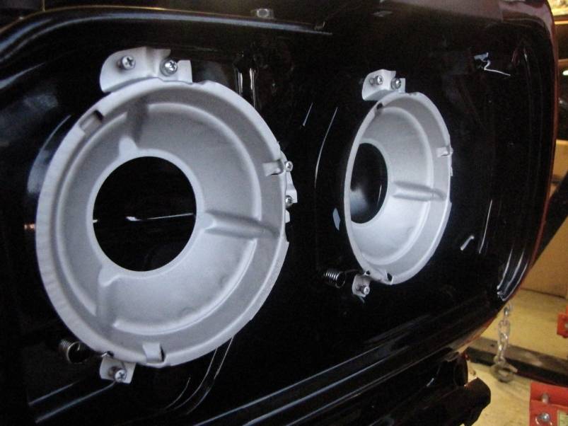

Another thing to bring up....Blasted the Headlight buckets. Galvanization was breaking down on them and rust was forming. Anyways, thought I would bring up that headlight buckets are specific to each location. Sure they'll mount in any spot, but you may end up with a lamp that will only install upside down or off key. I found out the hard way years ago so I figured I'd bring it up. Clean up the buckets and look for numbers on the outside lip. You'll see like "HI LO" or "HI" indicating if is a bucket for the highbeams or low's (HI-LOW is low beam on these cars). After that you'll a "LT or RT" (Left or Right).
Sprayed the buckets with Cold Galvanized Paint and installed. Throwing on a reference pic as well considering the service manual does not show it very well at all

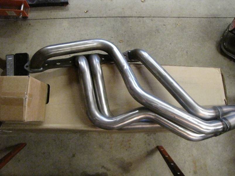

Brand new set of Doug's Headers showed up Friday....Real nice Quality! I'm impressed. Hopefully i'm still as impressed when it comes to installing.

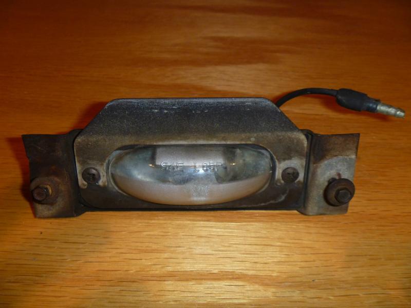

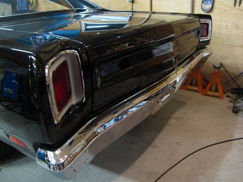

Rear ends pretty much wrapped up. Isn't much fun installing a rear bumper/brackets by yourself, but is what it is and had to get done. I'm glad I modified the the Bumper indents on the AMD quarters. The bumper might have fit on, but i'm guessing it would be rubbing or really really close. Trunk lock, trunk seal, tail lights, reverse lights are all in. On thing I am missing is the glass housing for the license plate light. Have the bracket/bulb housing but the glass housing is long gone. Anyone have an extra..please let me know.
