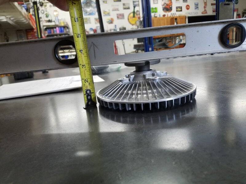

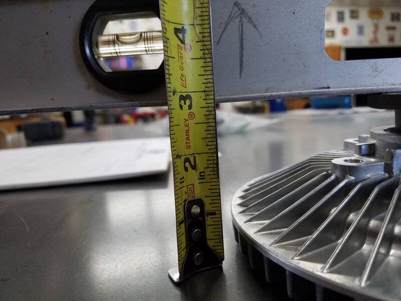

With my 1964 Dodge 440 426 Street Wedge 4 speed,I have the same problem with clearance. But it is because I want to use my 1965 Plymouth 426 Hemi radiator, and it will not allow clearance for a fan clutch. So today I am going to reinstall the factory radiator and go from there.
How many core's in that tank?
dmoore - Looking down though the cap I count 4 cores.
Went back to stock radiator in the 64 and looking down through the cap I count 3 cores and with a factory stock 7 blade fan I will need a 1/2 to 3/4 spacer to get it right.
Someone added that 4th core?
No...It is a factory stock radiator for a 1965 Plymouth 426 Hemi...part number 2524972 .
Also besides the part number 2524972 is DD, directly under that is CD and then AC next inline to that.
I hope that helps. You can also google that part number for reference.
Ok, so factory 4 core...interesting
