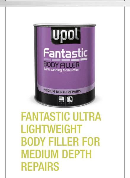

I ran out of my other light weight body filler that was supposed to be pretty good. It worked well but was a little difficult to apply and sand. It always tacked up my sandpaper on the first approach. I went to O’Reilly’s and decided to try this one. I can’t Believe the difference. The most amazing body filler! Goes on super creamy. no pulling or dragging or spots in it. First approach with a sandpaper no tack!!! I highly suggest this lightweight body filler.

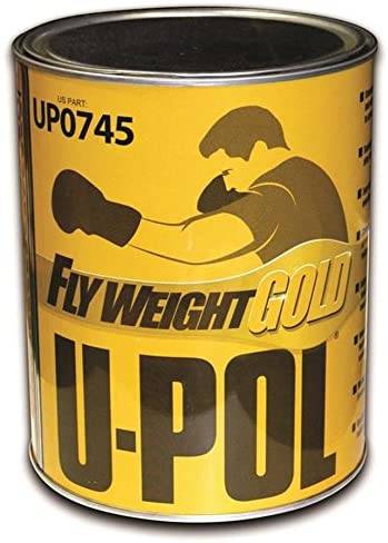

upol makes nice stuff...... havent seen that one before, this is also very good from Upol and not over priced
Becareful not to use to much hardner. It will bleed through all the primers and colors that you apply over top , and you won’t see the results till the clear has settled ..
Also. How is it for dry time? Pin holes? And blocking?
I have used the two part glaze putty. And there bumper skim coat filler. I cant say I was happy with the results.

Dry time is about 15 or 20 minutes. And then it is sandable. Blocking is way better than the other stuff I was using from Napa which I think was duel line or Dupline. No pin holes. I am very happy with this specific one. And I think it was $20 for the gallon

This could happen with any filler not just UPOL. Usually red hardener too.. Thats one reason I always use SPI epoxy for my sealer.
