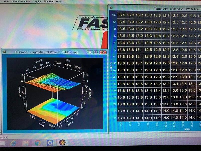

Hi guys,
I'm looking for some help from anyone who has a FAST XFI Sportsman setup on their engine. I finally have mine running pretty good, but I have a couple of little nagging issues with cold startup.
By chance, if anyone has this system and happens to have screen shots of the following maps - I'd be so thankful.
1. Target Air Fuel Ratio vs RPM & Load
2. Spark Advance vs RPM & Load
3. Pre-Start Fuel Squirt Table
4. Cranking Fuel Table
5. After Start Enrichment vs Coolant Temp
