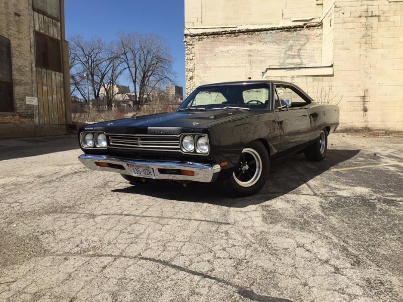

Not a good reunion, but at least a couple pic's turned out.... Here's the grouch sitting in a bit of a beat up part of town:
