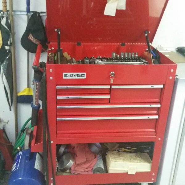

Mine uses a Harbor frieght tool cart. Holds everything I could ever need. https://www.harborfreight.com/30-in...&campaignid=12192887200&utm_content=120010558 I have a L bracket bolted to the stainless cabinet top. The top has nut-serts, 3 6MM bolts hold it. The L channel is bolted to the side of the box. Look closely at the right side you'll see the angle and one of the bolts. It is on wheels as well. Remove the 3 bolts and it rolls out.

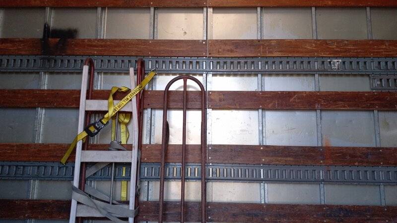

I like the E-Track too. Have two strips (Upper and Lower) on drivers side wall of trailer that I strap a small rolling tool box (Upper and lower tool box parts) to.
Also use the E-track to hold the spare tire to the drivers side wall.
I also have a piece across the front above the lower cabinets to strap down anything on top of the cabinet. Usually the cooler.

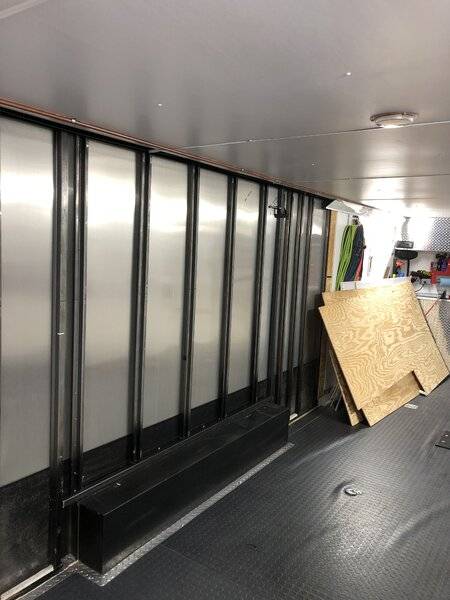

Whatever strapping you use, E tracking, angle, etc, to hold your box secure, you have to make sure that you’re hitting the vertical wall hat channels with your anchors. Those are always a bugger to find on a finished trailer because more often than not, those vertical channels are close at best for being accurately spaced on centre. Here’s a pic showing a typical wall.
Thanks. I think 2 of them will do the trick.jyst hope it doesn't dent my trailer walls and cabinet doors.
I’d put a 2x4 across the opposite side to spread the load and place the load lock where the ribs are located. You don’t need to put a lot of pressure on them. You just need to snug them up.
I have the E track down the entire length of both sides of my trailer to fasten everything to.
