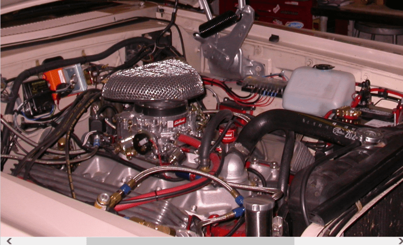

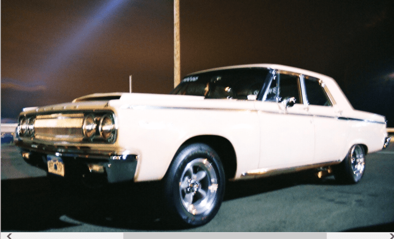

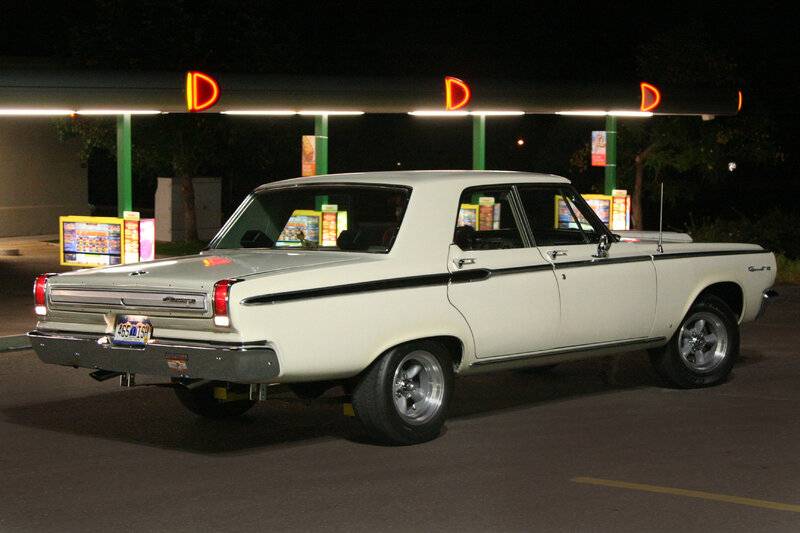

Guy I know took this 65 Dodge 4 door to 12.9's with a 150hp shot of nitrous.
