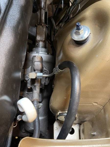

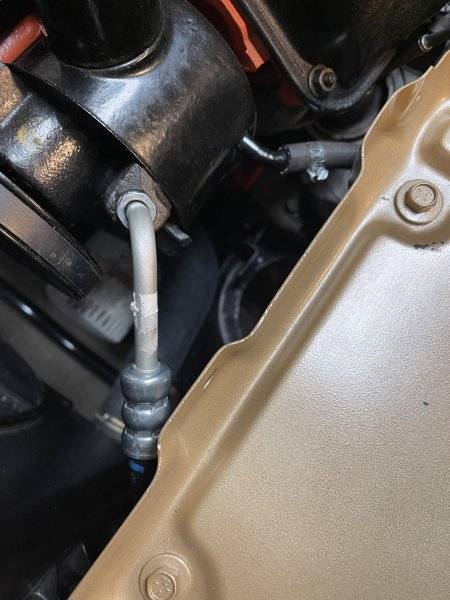

That makes sense. I did receive a message from the vendor I purchased the pump from and he said that the pressure relief valve that bolts to the top of the gear box, which the has the return hose connected to it, has two springs in it and if it gets stuck in the "open" position, there is no power assist. After I put the front wheels up on the stands and try to bleed the system, if it doesn't work, I will then unhook the pressure side of the hose and start the engine to see if I have any pressure coming from the pump itself. If that test shows the fluid coming out, then I'll look to the pressure valve on the steering box. This is my pressure hose to the steering box and pump. Thanks for all the responses, I'll get back to you with my results.
