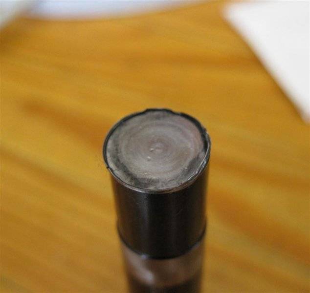

I would suggest fuel pump pushrod or sending unit pickup sock.
I agree. I had similar symptoms in my 71 Road Runner and finally one day it got so bad I could only get up to 20MPH, limped home and pulled the fuel pump and found this.

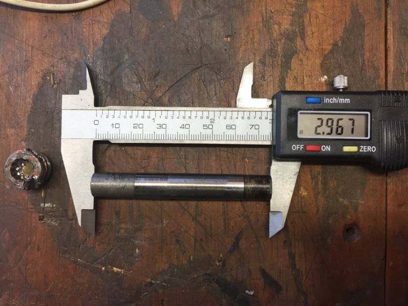

I also had problems with a worn fuel pump push rod, look at the picture.
It supposed to be 3.220" long, with this i was still driving but engine died under high load/WOT.
