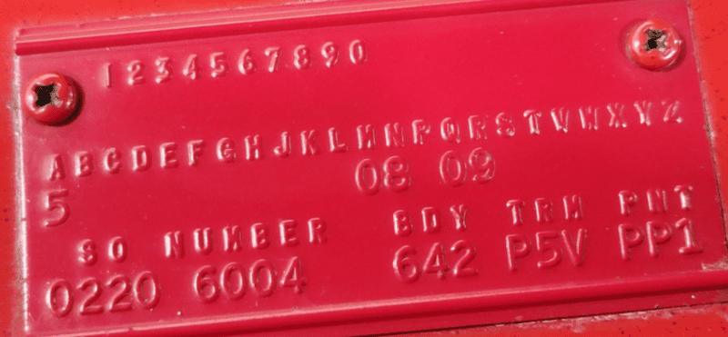

Where can find someone or how do I decode a fender tag? Thanks
Feb 20 1964 scheduled production date, the 6004, along with 0220 is the shipping order number. 642 is Dodge polara 500 two door hardtop with a V/8. P5V is white and red vinyl bucket seat interior.PP1 is red paint, roof and body. I don't have info on the L.A. assembly plant, so I can' t do the rest.
THANKS
other than a build sheet is there anyway to identify what drivetrain the a 64' was built with?
If your car has the standard engine in it it will not be coded on the tag. In your case that would be a 318 poly. Different plants put the codes in different spots on the tag. The 5 could be a auto trans. The other numbers don't make sense as engine codes unless your car was built in Hamtramck.

I don't believe that IBM card jibes with that fender tag in post 1. The S0 numbers are different. Tag is 0220 6004. Card is 0508. 4052.
That fender tag looks to me, like a hamtramck built max wedge car, but your car was built in L.A.
That would be my guess. I would check the body codes to confirm the IBM card is for your car. I'm sure it is but the body codes are a more accurate way to tell than the VIN. Body codes are harder to change than a VIN tag.
The radiator support, on the driver's side. Could be on the top or back of the support, and I believe there is the same code on the package tray. In your case the code is probably 4 5 0508 4052

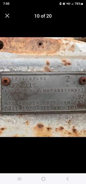

0711 1910- shipping order number. The first four digits are the scheduled production date July 11 1962. 311- plymouth savoy two door sedan with a V8. WWD- white roof, body and upper door frame paint. 101-blue bench seat interior. 6 under the B- three speed floor shift. 9 under theY- unknown. 2 under the Z- sold car. There is no engine code, so it would be the standard engine, a 318 two barrel poly. The top numbers have to do with the fixture the car was built in.
