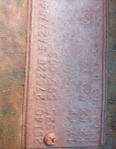

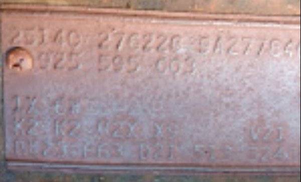

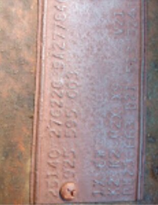

Hello everyone, I cant figure this one out. Can the experts please assist? Thanks in advance.
What I can identify, I think.
1X. 6?
K2 K2 W2X X9
RM23. E63. D21. 513. 324????

Rm23 road rummer hdrp
E63 383hp
D21 4speed
513 scheduled build date may 13
K2 k2 roof and body color
H2x upgrade black bench seat.
X9 black upper door frame
1x dont know
6w white double longitudinal stripe
925 595 ??? (Cant read the ?) Engine,trans, and rearend/brake package codes
25140 gate code, white body number
276226 (? Hard to read) order number
9A277xxx 69 model year, lynch road plant, rest of vin.
This is all open to questions, because its from memory decoding MY lynch road 69. But my reference book is 200 miles away.
E63 383hp E63 only tells us its a 383-4. It doesn't tell us the HP rating
D21 4speed
1x dont know (V)1x Black vinyl top. Lynch Road omits the V in front of tops and stripe codes
925 595 ??? (Cant read the ?) Engine,trans, and rearend/brake package codes Engine assembly code 925 This code is the one that tells us it's the 335 horse assembly. 603 = four speed assembly number
25140 gate code, white body number GATE 25 BASE 140 pertains to assembly of body in white.
276226 (? Hard to read) order number 176,226th body in white assembled that model year at the Lynch Road plant. The 324XXX in the lower right hand corner is the Vehicle Order Number (VON)
Lynch road is notorious for not putting options on the fender tag. Have you looked for a broadcast ? Found mine under the back seat bottom, tucked in the springs.
