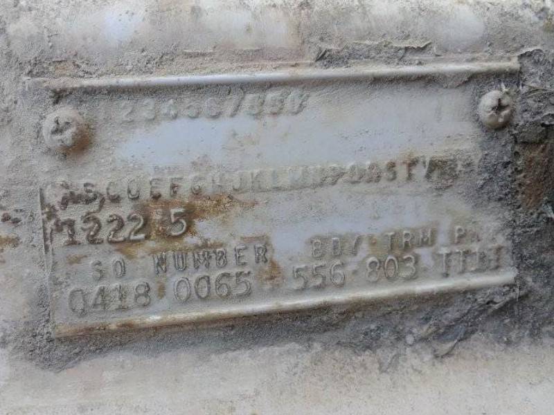

ok .. i don't know why i can't wrap my brain around this. i have run it thro all the links ya have got on here but keeps coming up with unknown on 1/2 of it.
only thing i know for sure is ... its a pink V8 car with purple guts. so if ya don't mind . help me out here a bit. ... thanks

How do you come up with a purple car with pink guts from that tag?
read that again ... lol
TT1 in pink single tone paint
803 is the purple guts .. and the guts are purple in the car....
The 3rd and 4th digits of your VIN would be a good start.
the vin i got figures out not hard to identify a 62 dart ..lol
5) dodge dart V8
5) dart 440 wagon
2) year 62
2)Hamtramck, MI
154xxx
now .. i have found that the MI plant didn't code everything.
as for the trim 803. im sure it will be per the model .. but im coming up with (8) bench in a dodge (0) no clue. thinking it should be a 5. (3) is Cocoa/Beige. maby its age but looks like 2 tone purple to me with the beige dash and lower door panels

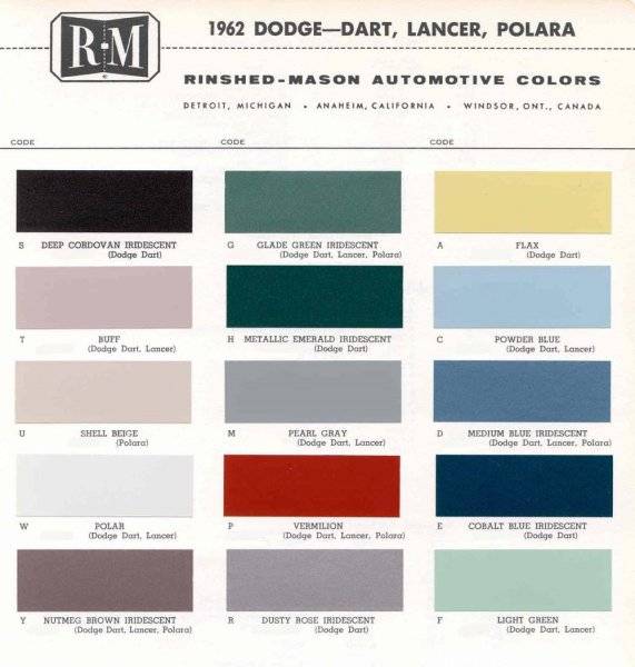

Not sure of the sources or what has been done to the car over the years but for 1962:
Paint code T is a coral gray/beige/sandstone color.
Interior 803 in a Dodge is a vinyl bench seat with cocoa or cocoa/beige color scheme depending on application.

TT1 is the paint code... and in the spots with no sun damage. under the hood and jams .... its pink what im finding its called buff LOL. pics on phone don't show it well but this thing has been pink from day 1.
Then it would code 99 for a non standard color.
LL = Buff, Buff is a very pale light pink.... Follow the link & go to the bottom row....
Then someone at the factory made a bobo. It will be at Carlisle. Come see it... It's pink...

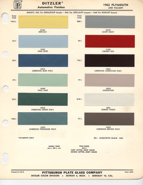

here ya go .... Dodge buff ... also known as sandstone on a Plymouth
... if that ain't pink.... and in real life ... its more pink than the paint chips.
