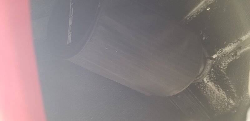

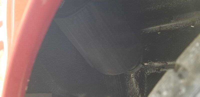

im interested in that air intake routing setup. can you post more pics of the air filter itself and anything that is happening external to the engine bay?

thanks - i was wondering about how things were routed with the filter. that might be my next move to get some fresh air into the engine

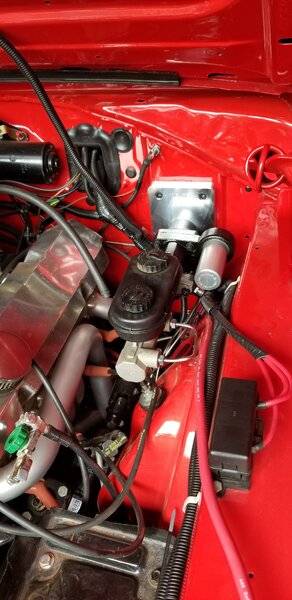

I put everything new as far as brakes go (stainless steel lines, master cylinder, vacuum booster, ect) but I was never satisfied with the brakes so this winter I put on a hydroboost booster. Wow what a difference. I would never consider going back to vacuum power brakes. I would probably just go manual brakes before I used vacuum View attachment 979044 View attachment 979045
What's the part number of the hydro boost and the hose routing?
