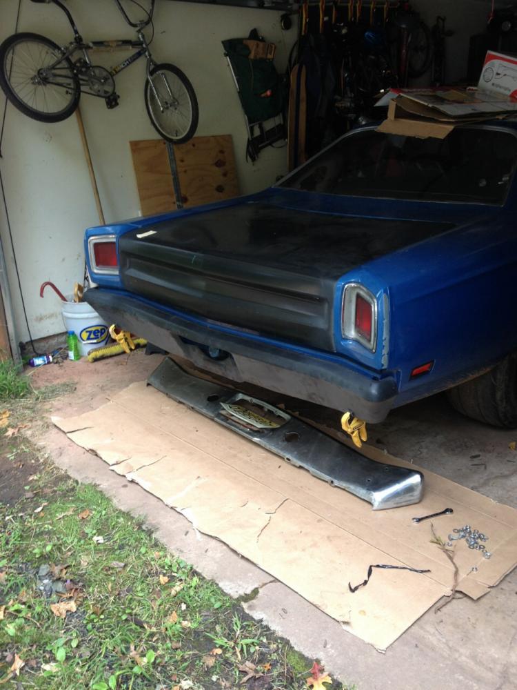

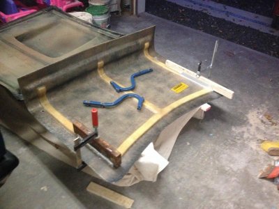

Just mocked up the fiberglass rear bumper and deck lid from glastek. Gotta say, the fit is excellent. No modifications - zero. So while I was at it, decided to fab some fiberglass bumper brackets, as the OEM units held the bumper a bit too far from the car for my taste. Should look much smoother now.
Anyone running a fiberglass deck lid? I have the crazy notion of mounting the deck lid to the eom hinges (no springs) and pinning it down. Maybe add a prop rod as well. The whole concept of this car is a crazy blend of street and strip, and with 3 young kids, I think I want the best of both worlds, glass deck lid, but not a lift off deal.
So I need some ideas for pinning, the rear pins look pretty straightforward, but the pins toward the front of the car might be a challenge. Maybe I'll use dzus fasteners instead? Don't know too much about them dzus's.

Very nice as they look real good ! Even the baby likes them. LoL. But yes they do look to fit real good ! Ron
how much if you don't mind me asking, might do front and rear bumper and deck lid one day
No worries, Ben, I bought them from a member here and got a killer deal on them. If I recall, I paid $240 for the pair and was able to avoid shipping because he happened to live right on the way home from my summer vacation.
The pieces were new and unused because he bought them for spares and never ended up using them.

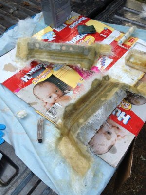

Yeah I'm pretty stoked about the brackets. I only just laid down the first layer of glass so they have a ways to go. I feel like I've learned so much since making my fiberglass shroud, these babies are really turning out nice.
Looks great! I see you already have your engine diaper too.
Are you talking about running four pins on the deck lid with 2 near the window and two at the back end and use hinges too? I don't see a need to run more than the two rear pins if you plan on using hinges. Haven't had much experience with glass but thinking about diving in and making some parts....
Yep that's exactly what I meant, crank. I was thinking I've always seen guys running 4 pins or like a dozen dzus fasteners so that's what I had to do. but I've never seen anyone use the hinges.
Yeah maybe I'll just use the 2 pins for now and see if it feels secure. Maybe cruise down the highway with my buddy in the back seat making sure it doesn't look like it's going to take flight lol.

I'd say 2 pins should be more than plenty, especially if it's attached to the hinges in-front,
unless the deck-lid is really thin, with no understructure for strength, or something along those lines/style...
Dzuz fasteners are cleaner looking...
that's what I had on my last 68 RR, 7 of them 3 each side & 1 in the middle on the top,
but it was a lightweight lift off/race weight style deck-lid from US Body Source IIRC
there are some flush mount or twist lock or pop up styles hood latches too,
I've never used them, but would consider it,

Thanks, bud, for the input. Two pins it is My next trick is to glass in some mounting points for the hinges, should be loads of fun. I'll have to see how stiff the deck lid turns out once Im done.

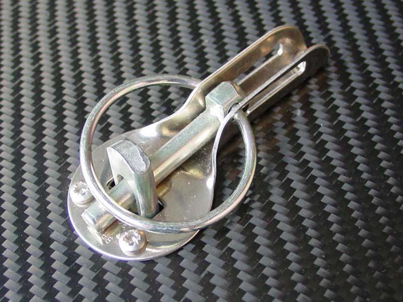

I've been thinking about going with these sliding pin set ups. No tools, no pin to lose or lanyard to scratch. Though they might look a little European for an American muscle car IMHO (no insult intended to my European friends lol). Or maybe I'll just go with the traditional pins.
I have a UP bolt on hood on my 66 Belvedere and it only has 2 pins in the front. It's also a piece of crap but it's stayed on the car but has never seen anything over 100 mph. Had to reinforce the front edge because it was trying to flip up. It's thin and light and the finish sucks. Bought it over 20 years ago.

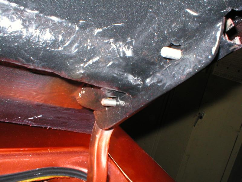

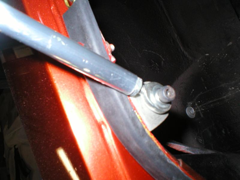

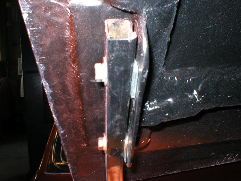

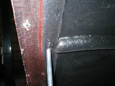

I just put a fiberglas trunk lid on my 65 Coronet AWB using the stock hinges....I fiberglassed a piece of angle iron to the bottom of the trunk for the stock hinges to bolt to...put two threaded holes in the angle iron to bolt to stock hinges...works great...put two Dzus fastners to hold it shut and built a prop rod to hold it open...can post pictures if you want....
Farley, that's exactly what I'm looking to do, thanks for chiming in. Yeah, pictures would be great.

You should have no problem on the trunk. I only run 2 hood pins in the front of my glass hood on my 63. And its a race type hood as its not enough meat to use hood hindges even if I wanted to in the back of it. It looks to be a fairley light hood as I was thinking I may have to add a center pin in the front but I have not had to. It does not lift in the front center at all even at 125 mph in the traps so I would think you will be fine on your trunk. Ron

Thanks again mark for the pieces. Those glastek pieces are great, nice edges and really straight. unlike the front bumper that came on my car, not sure the make but it is still unpainted and is actually see through in some places, the bumper has a little twist and warp to it and the cutouts look like they were done with a Sheetrock saw.
I've been looking at the front mounts as well. Like you said when I stopped by, the fronts are a lot more involved. I was thinking of maybe trying a fiberglass unit with some angle or box aluminum reinforcement. But that'll be a project for this winter as I wait to save enough cash for the engine build.
Tonight I plan on pulling the rear seat so I can get in there and mock up the hinge placement and start planning the angle iron reinforcement.
I also have a cool idea for mounting the pin brackets to the body. I don't like the $45 units it seems everyone is selling so I found some cool anodized aluminum gusset brackets for like $7 a pop. I'll post a pic later.
image.jpgLooks great, Farley. That is exactly what I'm planning. Thanks for the pix.
Here's the bracket I'm planning on using to mount the pin to the car.
