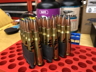

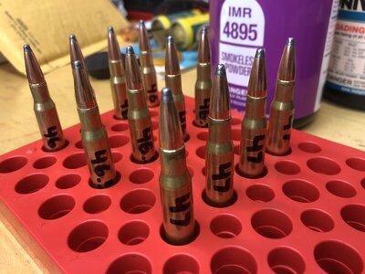

Loaded up some cartridges for the Garand this evening.
150 grain bullet
Remington brass
IMR 4895
4 rounds with 46 grains
4 rounds with 46.5 grains
4 rounds with 47 grains
I’m going to see how they cycle, and pick the one I feel is best.

I've never fired soft tip rounds trough mine, afraid the tip my get deformed during feeding from the clip and affect the ballistics. Have you ever noticed anything like that? Maybe the odd round that flies off on it's own or something like that?
