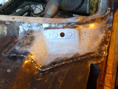

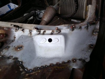

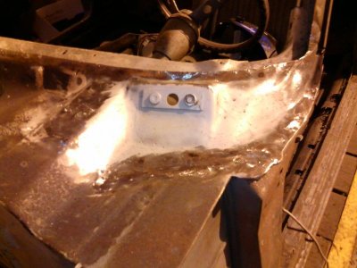

Feels good after 30 some odd years of sitting. Hope to get the cowl back on by end of summer. 0515131230.jpg0516131233.jpg0521131222.jpg

So many spot welds, so little time! LOL
Looking good! You early B-Body guys sure have some amazing battles with cowl's...almost surgical. Keep up the good work.
Nice work! Does seem like an odd place for corrosion, what was it about the design that made that so common? They changed it later on?
No drain on drivers side in 64. 65 had a drain but a few leaves would clog it up. I'm putting a cowl from a 65 on my 64. ssshhhh don't tell the purists. LOL Roger did you get your car yet?
