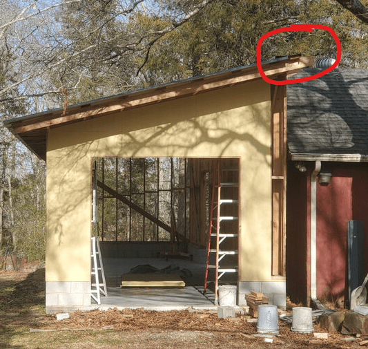

The "little" gap on the right - I'm torn, would like the siding panels to continue into the center section.
So . . . I might get something installed so it can be removed to allow the panels to continue . . .

Speaking of little gaps.....have you got plans for a wide centre ridge cap eventually to bridge the gap between the sections of the building?

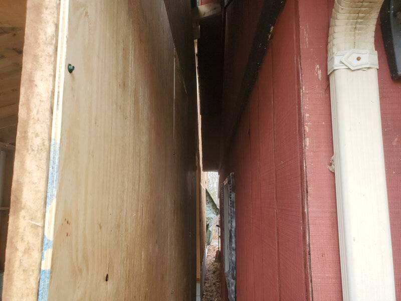

Roger - the red building is not going to be part of the new shop - it's in the way - once I move all the contents of the red building to the new building, then I'll dismantle (probably relocate) the red building - then start on building the "new" center section which will probably be 26' x 50'.
Hope that makes more sense now . . .

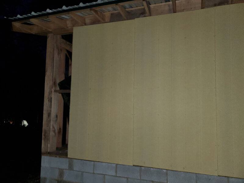

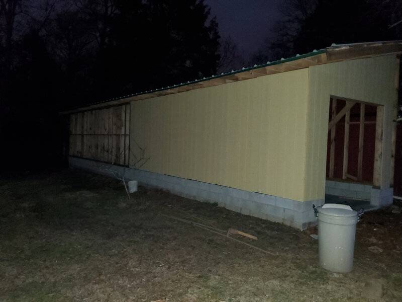

Good week, working under the spotlights . . .
Wanted to take advantage of this great weather and get some stuff done this week on the shop.
Decided that working with spotlights after work was a necessity . . . so it began . . .

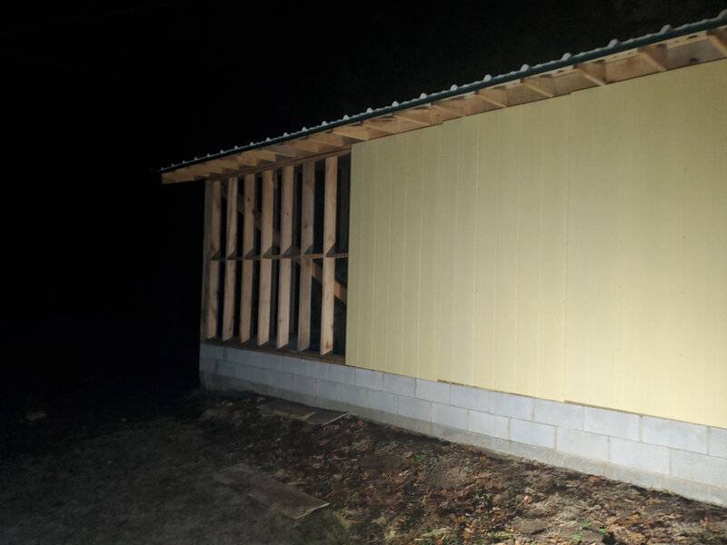

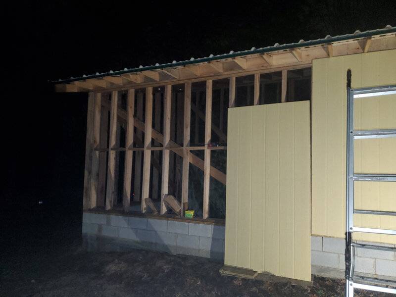

Tuesday night progress . . . got 2 more panels installed . . .
Wednesday night progress . . . got 4 more panels installed . . . only 2 left . . .
SIDE NOTE - make your length a factor of 4 so the panels will fit nicely . . . I'll need a 2' piece at the end . . .
Got that last piece installed . . .
Thursday night progress . . . got the last 2 panels installed . . . only the 2' section remains . . .

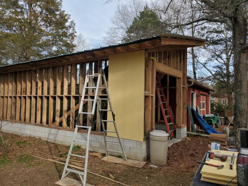

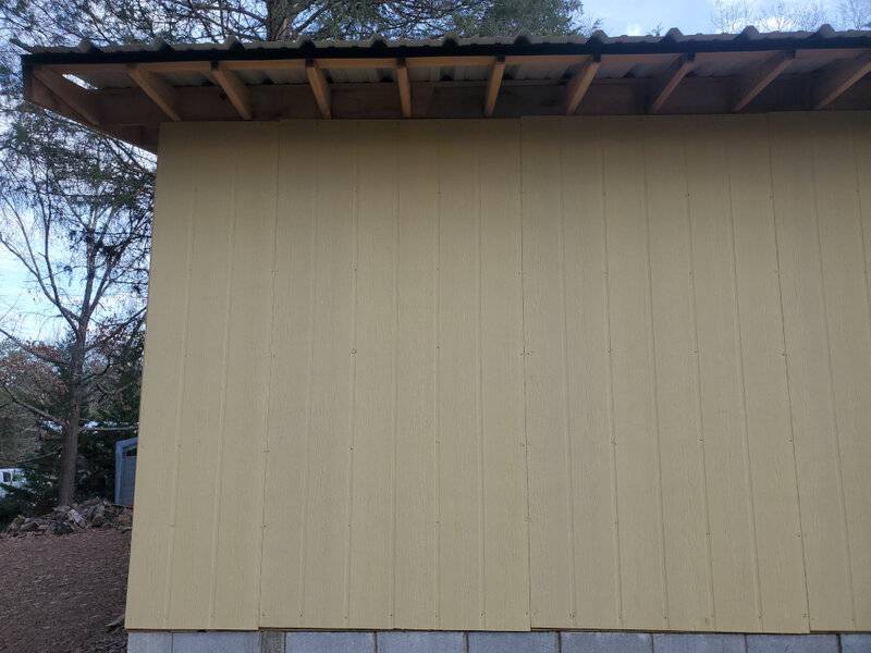

Half day of work . . . and some great progress to boot . . .
Was really happy with my progress today . . .

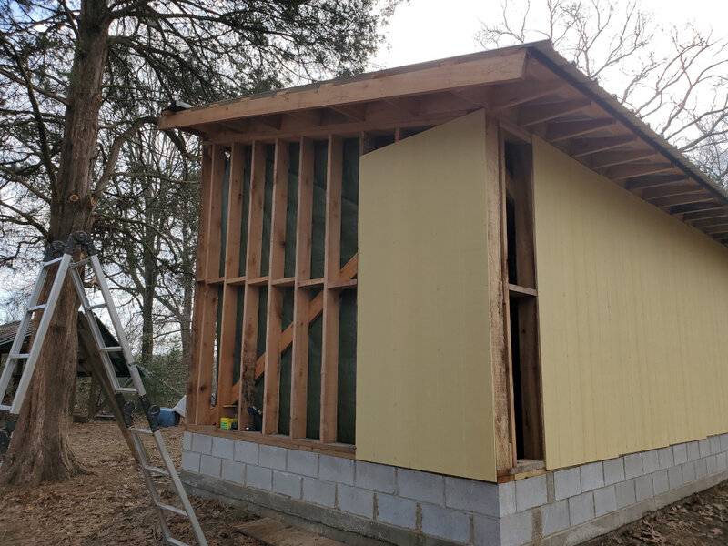

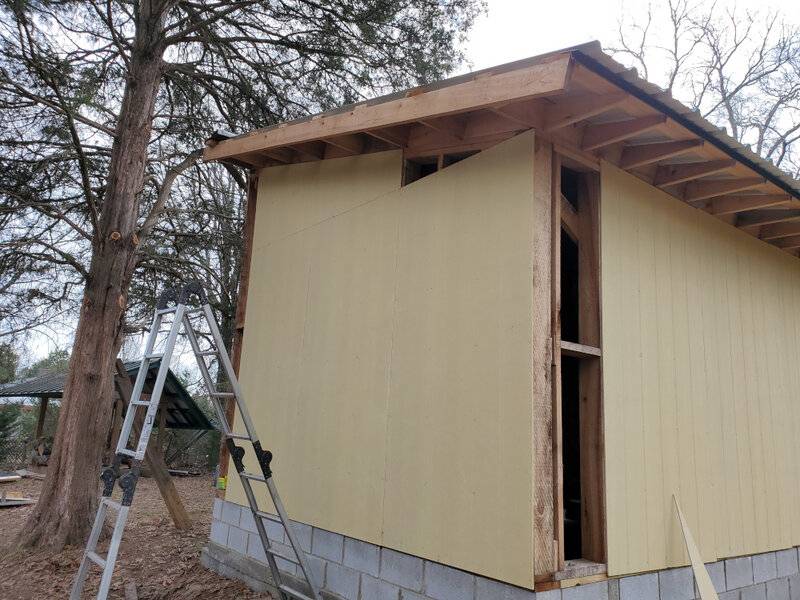

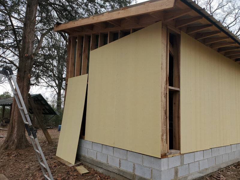

Got started on the back of the shop . . . 1st panel . . .
2nd panel . . . 3rd ready to go ( forgot to get it before . . . )
Got the 3rd panel installed . . .
And the first upper panel . . .
And the 2nd upper panel . . .

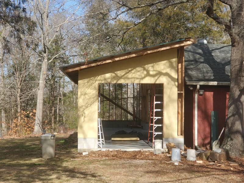

And finally, the last upper panel . . . back wall is done ( except the small gap . . . like the front ) . . .

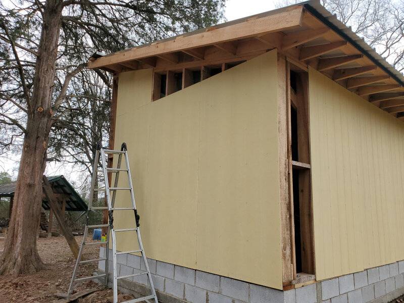

What a great sight . . . sure is nice to see this coming together . . .

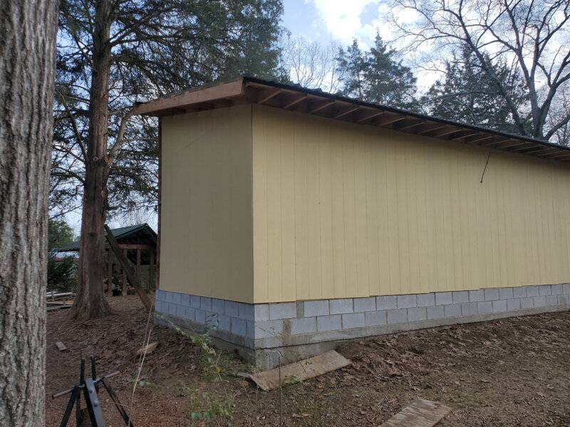

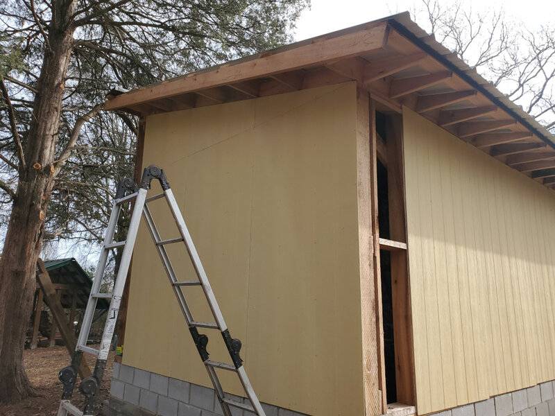

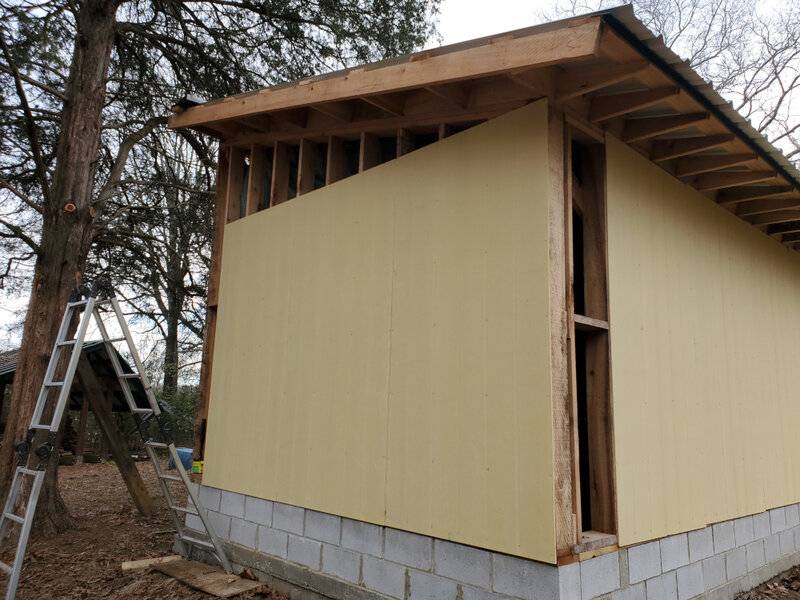

Also, got that last 2' section installed on the side of the building too . . .
ALL of my siding is now up . . .

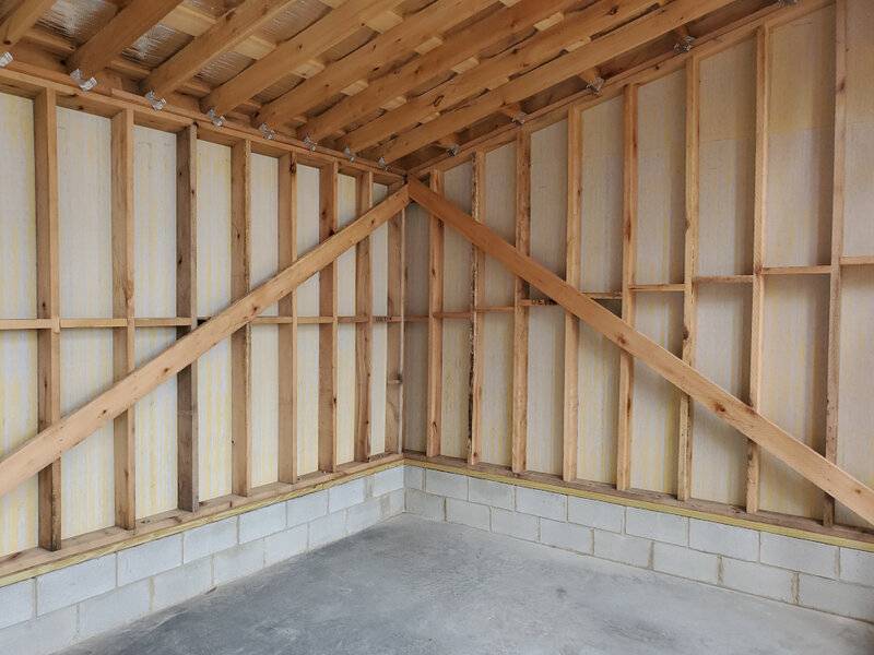

And . . . what a wonderful view it is from the inside ! ! !

The view from the inside sure looks great . . . can't tell you how good this feels . . .

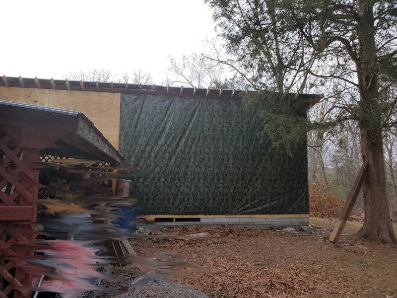

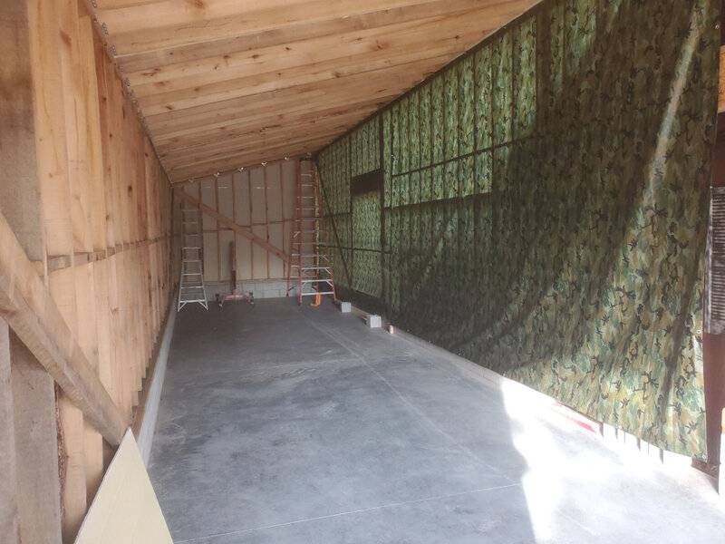

Relocated the tarps on the center section wall . . . hope to "try" and keep some of the water from the upcoming rain out.

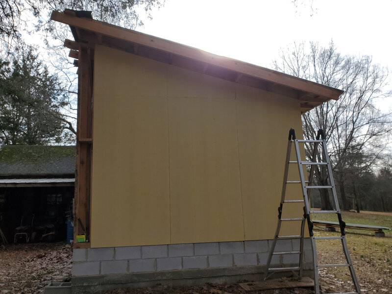

But Here's the scoop . . . did not like the tarps, and I really need something more solid and secure.
So I bought 19 sheets of 4 x 8 Plywood and set off on the task of covering the wall . . .
Might not think it's too much of a deal . . . but . . . when you have this to work with . . .
( note - this looks like most of the housing developments that are built these days . . . )
It makes it quite challenging . . . to say the least . . .
But . . . as the day progressed, I worked through the pain and really needed to get this done (rain tomorrow)

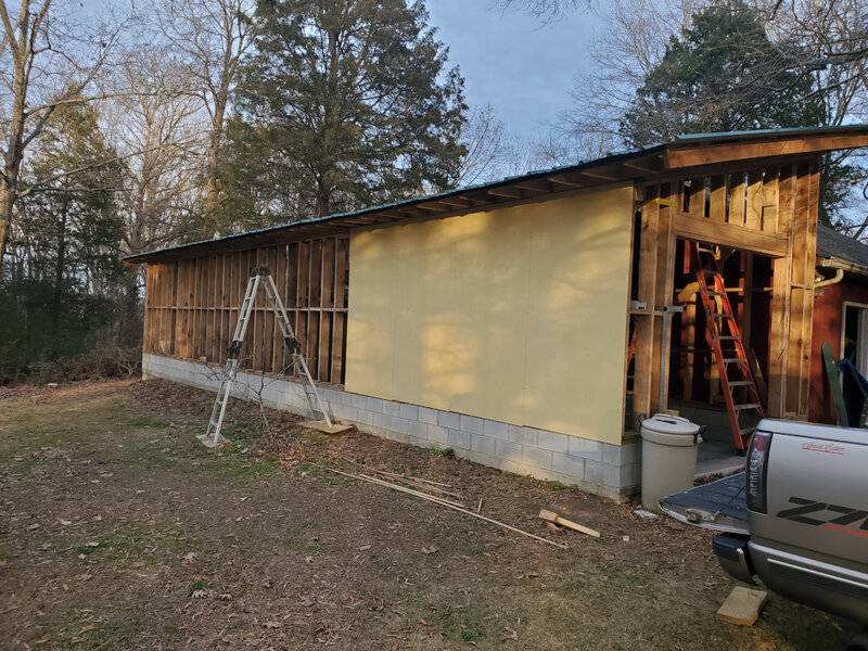

And . . . got all 19 sheets hung - screwed in place so they can be removed when the center section goes up )
And the front section . . . even the (2) small sections were completed ( screwed in place . . . )
Still worried about the rain and the plywood - did not have time to get primer or pain on it
So I got (1) of the tarps put back up with the hopes that it'll help to keep things dry . . .
Time will tell . . .
And the result . . . I'm one very sore individual . . . Like I said, probably going to feel this in the morning
Probably for a couple days too . . . to boot . . .

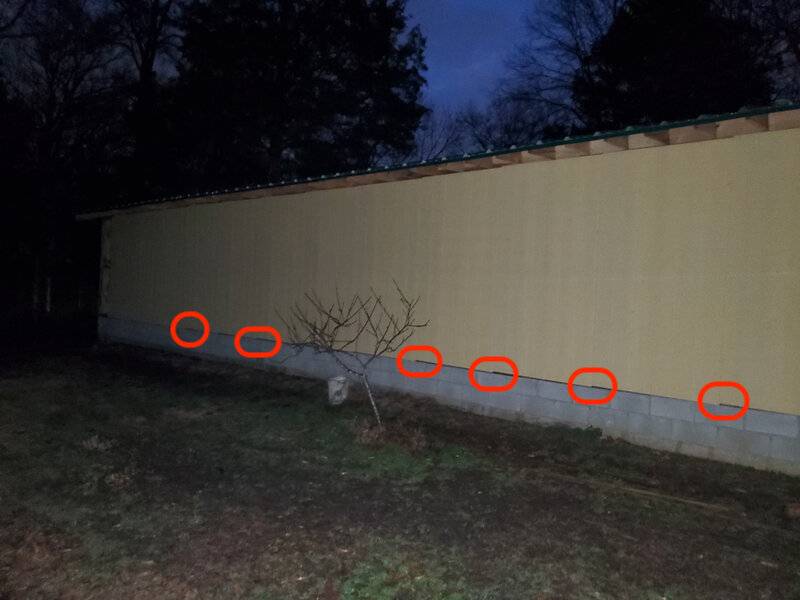

Had leaks like this almost the whole length of the wall . . . and for good reason . . . the wind blew most of the covering off

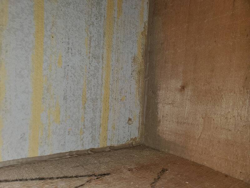

So - round 2 - after the first failure . . . got a bunch of re-work done, and even managed to get some "temp" lighting !

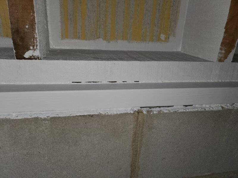

Also went around the shop and was applying Liquid Nail on all the gaps - here between the studs and the siding
But it is also being done on any gaps between boards that I can find . . . to try and keep critter "out" . . .

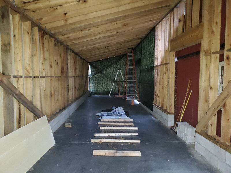

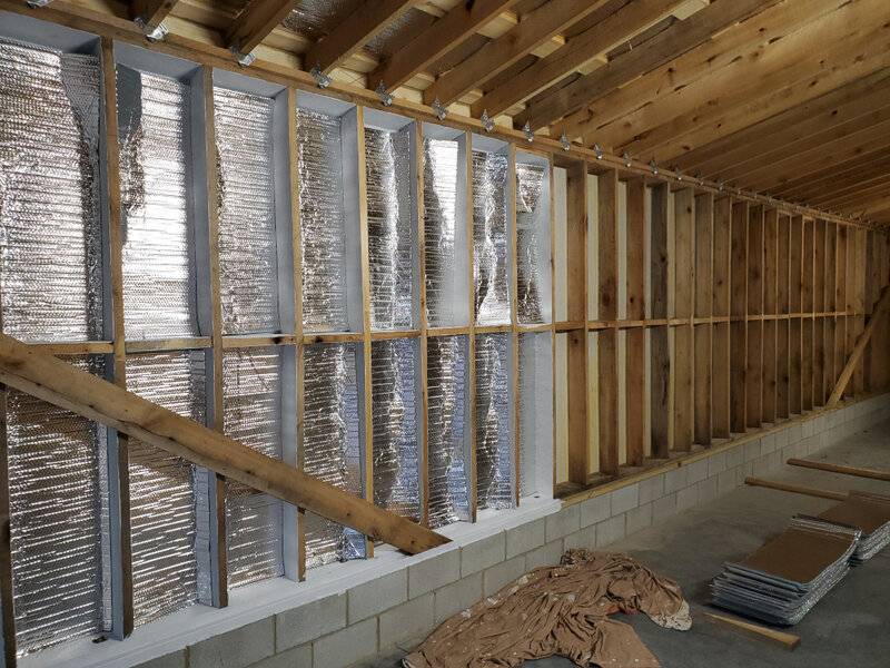

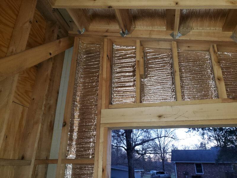

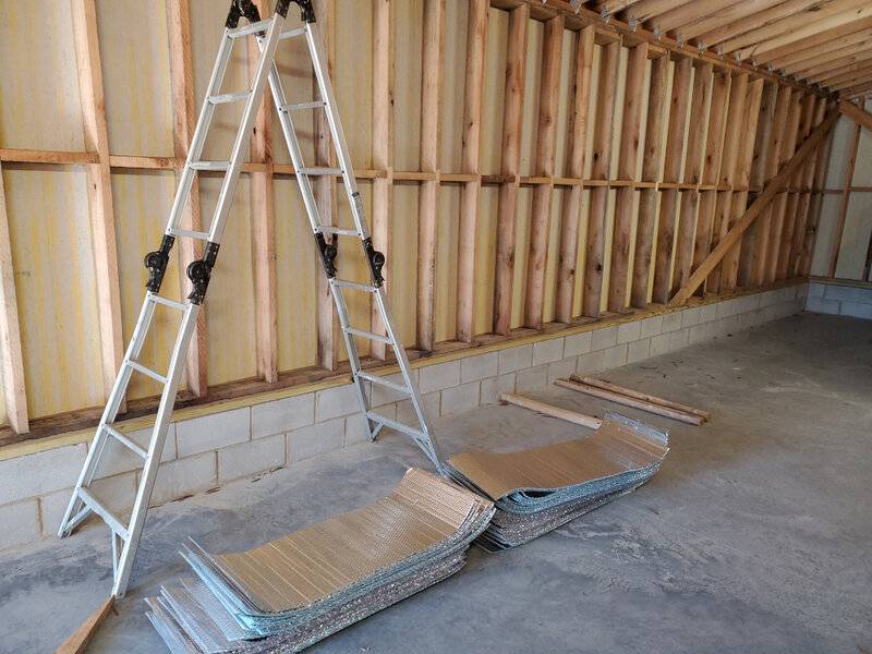

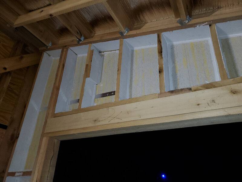

Next will be the radiant barrier that will help to prevent the heat transfer from the siding . . .
Had a bunch of it all cut up and ready to go . . . and then I had a "better" idea . . . Don't know about better
Let's call it "another" idea . . . to help protect the lumber . . .

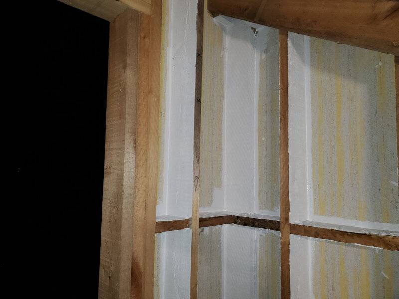

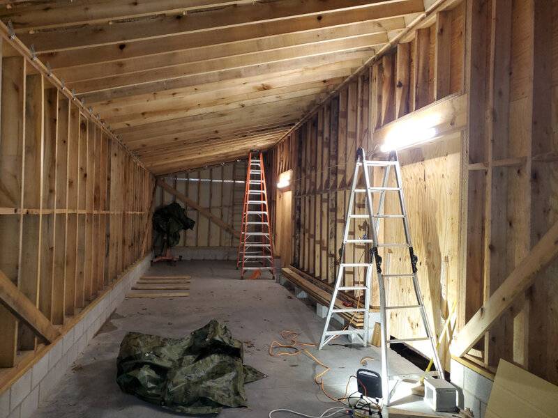

Had about 1/2 of a 5 gallon pail ( ok, 20 liters ) of paint that I did not like in my house, and could not return
So it became "elected" to covering the studs to help protect the lumber in the shop . . .
One space - you can see where I added more liquid nail because I must have missed it the first time around . . .
The remainder of the door wall, and around the corner to the side wall . . . 50' of wall to paint . . . oh, boy . . .
Plugging my way through it . . . BUT . . . this was one of my "wins" . . . or, almost wins . . . I guess . . .

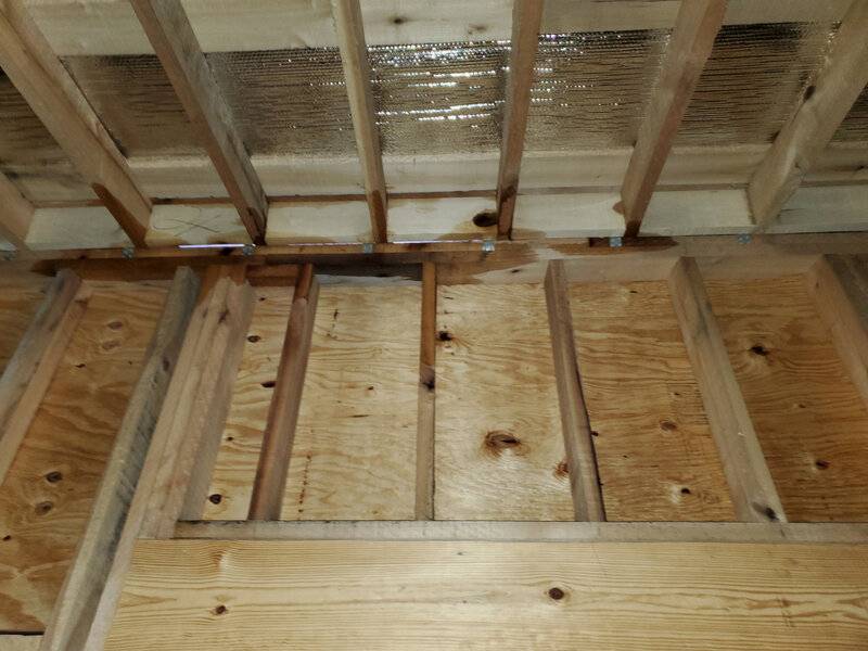

Why did I say "almost" . . . because it was the first test of the re-work on the peak water sealing . . .
And I only had (2) very small leaks, that I'll be addressing this week ( and hopefully have that all behind me )

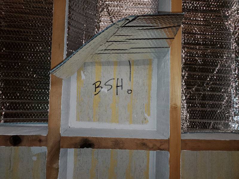

As you saw before, the painting also help to "find" other spots (gaps) that were missed and nee more attention . . .
As always . . . had to leave my trademark of my work on my project . . .

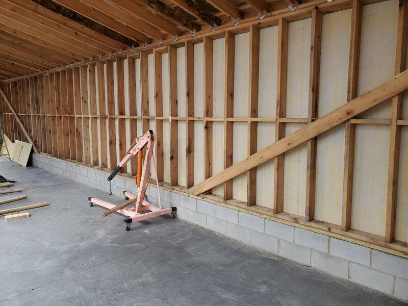

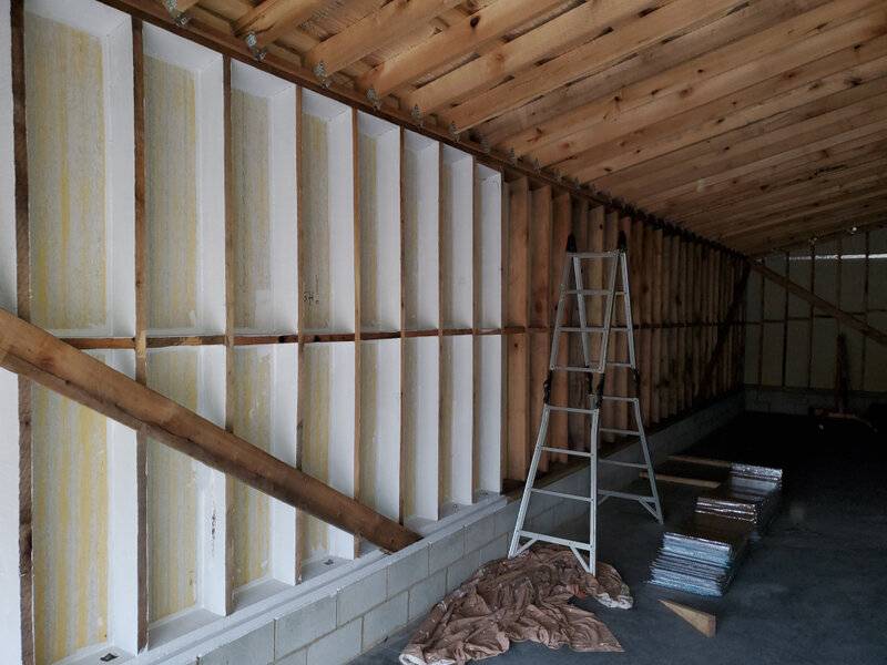

This is about the 1/3 point on the wall, all painted and radiant barrier installed . . .
And the 2/3 point . . . also is the sealing of all the gaps between boards that I can find . . .
If I ever have a tornado here to contend with . . . I'll be spending my time in this shop, not my house . . .
Also to note - the 6" space will be filled with insulation . . . and I'm leaning toward Rockwool . . .
Fiberglass insulation for 6" wall is rated at - R-19
Rockwool insulation for 6" wall is rated at R-23 ( ugh . . . and about 2x the cost too )
So, the rest of the week will be, painting (until I run out of paint - of "course" there's a paint shortage too )
Installation of the rest of the radiant barrier - plus cutting it all from 25' lengths for the back wall . . .

None of my concern by I think your sheeting was trying to tell you something.... Kinda late at this point but might be good to know as your build continues....
I know . . . I saw it . . . and it did NOT make any sense . . . and moving the walls was not likely going to happen . . .
The odd thing is the front garage door wall reads perfectly plumb . . .
SO . . . the blocks have a slight tilt to them ? ? ?

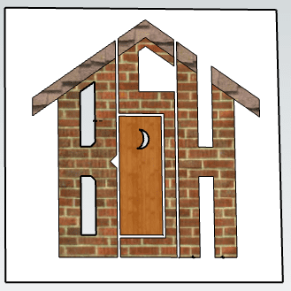

What does BSH mean . . .
Interesting . . . nobody has asked what the BSH means . . . unless everyone already knows . . .
So here's my moniker for the fabrication projects . . . and any project that I build . .
Maybe you can "de-code" the meaning of BSH . . . from this . . .

Big Sledge Hammer ? That's what I ***-umed it to be. :lol:
