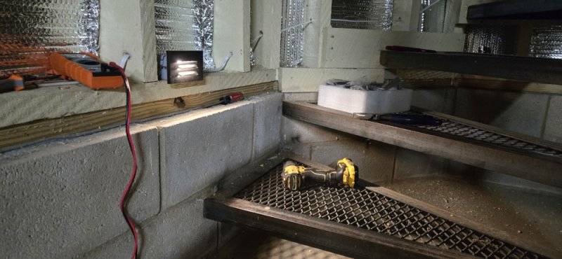

Got this work done on the silo - once I figured out what light that were getting installed . . . They are just Deck
lights - but they hug the wall and thought that prevent them from getting bumped all the time . . . maybe ? ? ?
This is the first light . . .
And the second light getting installed . . . appears that the 6 lights in the kit will work out just fine too !

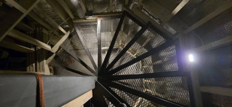

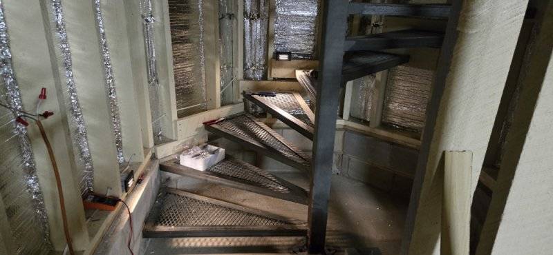

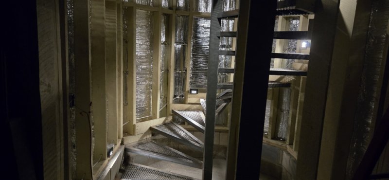

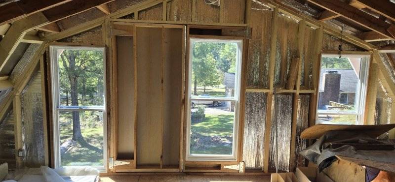

Working my way up the spiral staircase and really liking the results . . .

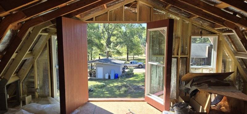

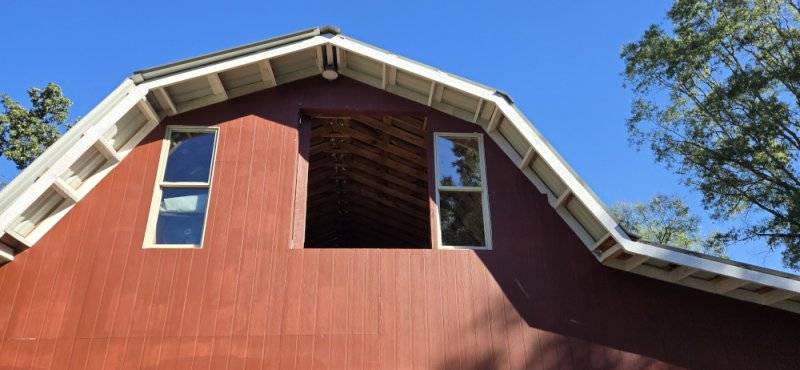

And, when it was finished, the view from the top was awesome . . .

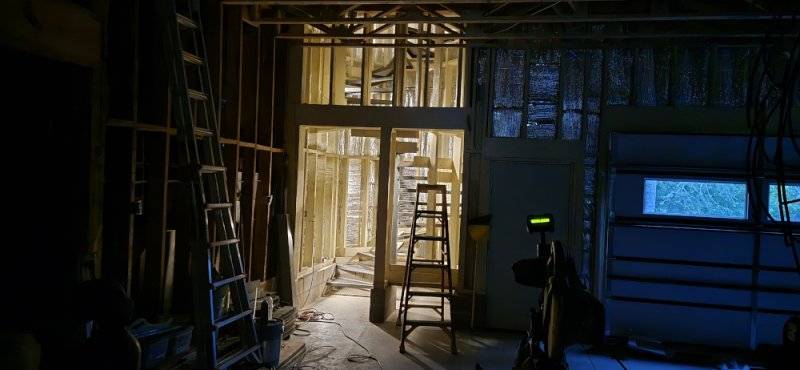

Getting dark outside so I checked out the lighting from the shop - happy with the results !

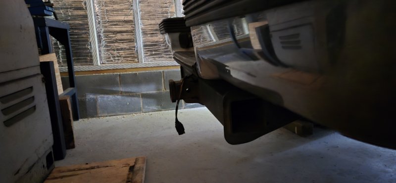

And - finally got the truck in to work on the bent frame from the accident - when the Toyota Tacoma drove
ringht into the back of the truck on the interstate . . . at least the receiver is now level - not pointing down . . .

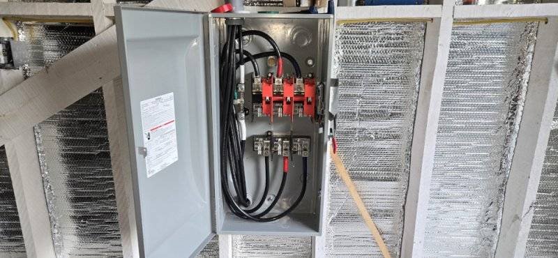

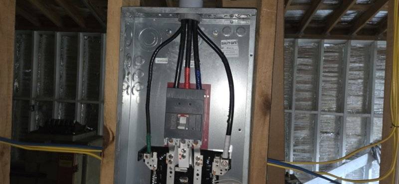

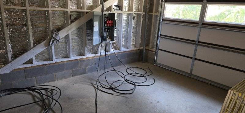

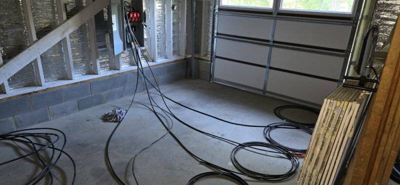

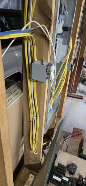

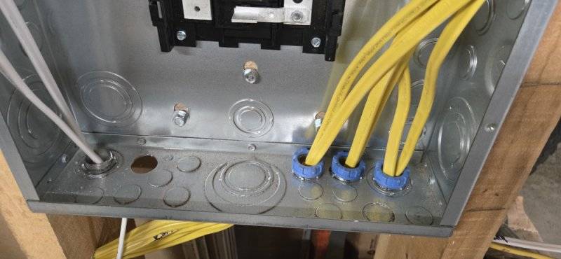

And now working on getting all of the electrical circuits into the can and getting all of the circuit breakers
installed to handle them . . . moving along . . .
And working on trying to make sure that the wiring in the shop looks respectable for the inspection too
Yeah - dragging my feet but finally realizing that it needs to get done so I'm pushing myself a bit harder
to get this thing done and just fix anything that was done wrong and move on . . .

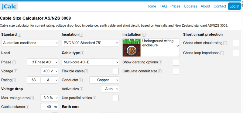

Did you try any of that slick-ease(?) or some such for pulling wires? Used to use it when making wire conduits on buses.
The biggest problem I have seen people make is using a counduit that is too tight for the cable run, and too many bends.
Bends create resistance (friction) when pulling the cables, and the duct being too small will create heat build-up inside over time. Always go bigger than what you think you need..... don't base duct or conduit size on the amount you have in your wallet.
There is also a calculation you need to make called 'Grouping factor' - which means there needs to be a percentage of 'free space' inside the conduit to allow for heat build-up (in basic terms).
