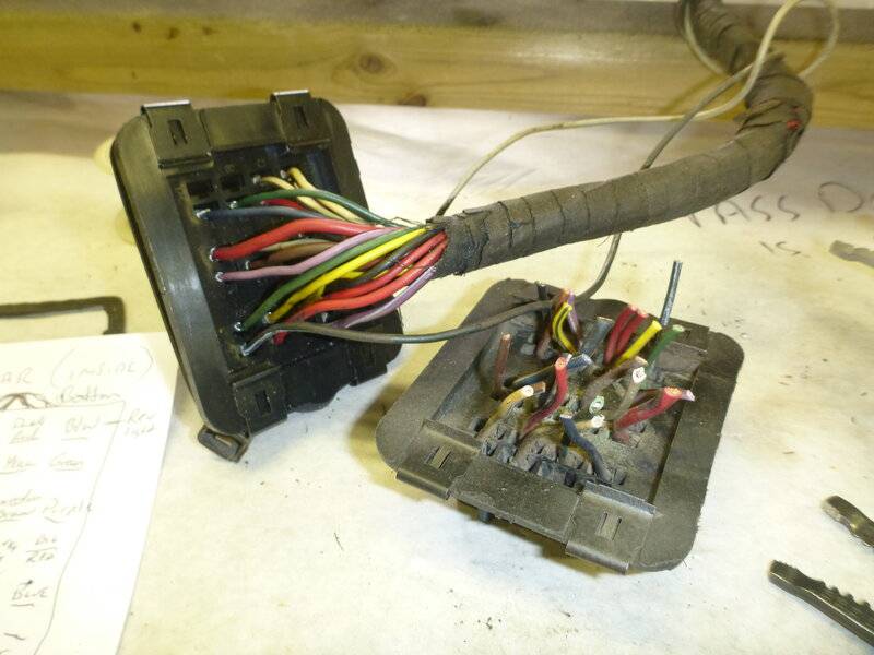

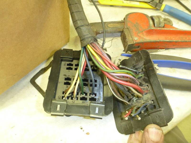

So I am in the process of rebuilding my instrument harness and perform the MAD ammeter bypass mod. The fuse box and Bulkhead connectors are in good shape but the fuse terminals have some rust and and I want to do more than use circuit cleaner BUT I dont want to degrade the plastic or wire insulation for the wires that remain fixed to the fuse box.
Question is what is a good compound to clean the ruse off and get the terminals looking bright clean and allow for best continuity?

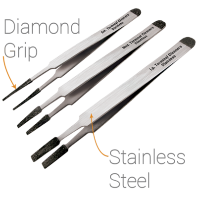

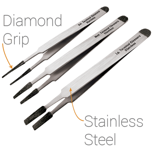

I used these. Industrial diamond coated.
