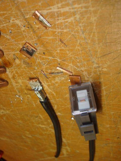

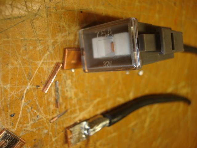

First of all, I decided to upgrade the supply from my alternator to the battery, and also eliminate a large load from the in-dash ammeter which is a constant trouble spot for most. I went to our local Auto-parts store, and found a nice 75Amp plug-in fuse (following advice from Paladin06 here). That was the start of a small problem. The female terminals on said fuse are larger than regular terminals, so I had to fabricate a new connector. They are the same size as headlamp terminals in case anyone was wondering.

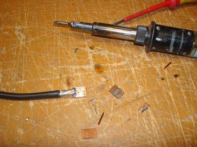

Step 1 – take a section of household switchboard busbar and cut into sections. Then solder on a new heavy duty cable – 6mm sq. CSA (3 times the size of the standard Alternator cable) – run from alternator to starter relay terminal.
I had to use my Propane powered gas iron to solder this wire just to get enough heat for the solder to flow nice. Shaved the copper bar down to be a snug fit into the fuse terminals.

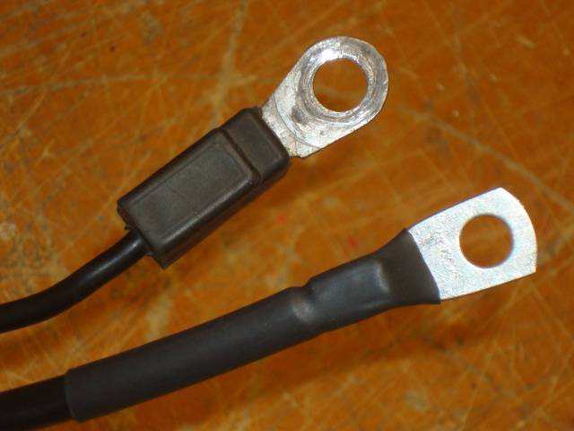

Also used some thin-walled self-sealing heat-shrink tubing to tidy up the cable ends on the lugs etc.

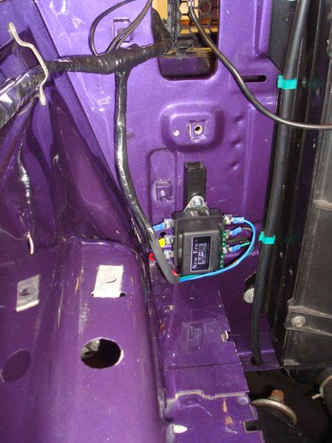

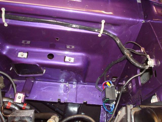

Next step is to fabricate a mount that will hold the new combined relay unit for the headlights. Stealth position selected under the battery tray. I found two factory holes that worked perfectly once the block was ready to install. New relay is “Made in Japan”, and is the best you can buy for the job. I was going down the separate relays and diodes path, but this is virtually idiot-proof to install, and makes a tidier job.
Relay and wiring in position under the battery tray location.
I managed to cut into the original loom behind the headlight buckets, and run the control wiring in with the original loom to make a tidy finish. Barely noticeable now that the correct tape is installed. I have kept the original feeds across to the passenger side, as there is only a 0.25Volt drop between the sides.
End look at the battery –

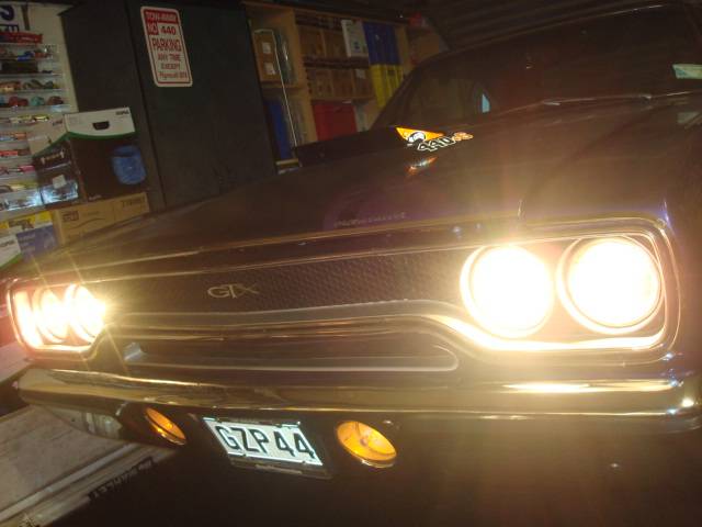

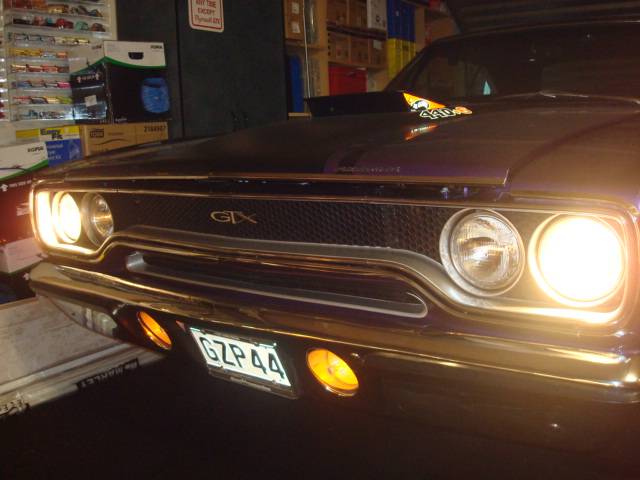

The headlights are much brighter now, and although the voltages tested show a mere 2.5V increase overall, the results are clear to see with the lights on. It also means I have diverted the bulk of the current away from the ammeter, which as we all know is a source of many problems. The only current going through the light switch and dip-switch now is for control only of the relay.
