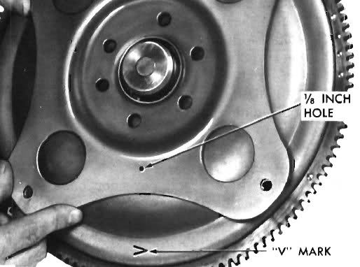

Miller - I'm going to look into the flex plate hole issue some more. If I can come up with some way of centering everything I may re-drill mine. Any hole is going to have to have a few thousands oversize. After working with manual transmissions for years it just seems weird to not having something that really centers the transmission input like a crank bushing.
Question - I got what appears to be a proper 10 inch pattern, stock flexplate from Mancini - but it still has 3/8 inch bolt holes. The stock 5/16 inch bolts are lost in them - but they are definitely smaller than 7/16 inch. So what accurately centers the converter on the flexplate - just the engine dowels? I didn't spend a lot of time looking at the crank when I pulled everything apart - does the crank center the converter snout in the bushing recess that closely? Seems sort of imprecise.
I'll try to explain on the centering of it...or, toss some more mud at it!
Imprecise...not really, considering that yes, the flexplate flexs. That's mostly to absorb vibrations, since if there was none, it could wear out parts a lot faster.
If you notice in the pic of the flexplate, it sits between the crank and the converter (of course!) First thing mounted up is the flexplate to the crank, that has the center hole that fits over the crank end, and pretty much 'centers' it at the crank. The crank/flexplate bolts lock it in place, and much of the time lines up to balance it, via bolt pattern/balance marks.
When the converter itself is installed (with the trans itself), the converter snout fits into the flexplate hole, and the rear of the crank. Of course, just the block/trans housing dowels line up trans to block, and the two centers, unless something is flat wrong. That puts all those parts inside the accepted centers, considering the flexing of the rotating parts. Bottomline is, it works.

And, what size bolts were on the converter/flexplate. Some of that aftermarket stuff can toss kinks into things.

Miller - I understand the flex plate centers on the crank hub. But is there really engagement and self-centering of the converter hub into the crank? Otherwise the converter can end up bolted to the flex plate off-center. I don't see any sort of machined, precision converter hub to crank hum fit there. At least with a manual transmission, even if the bell housing is out a little, the pilot tip on the input and crank bushing bridge over that - and with a stock bushing and the floppy front ball bearing input, any slight misalignment is usually a non issue. Apparently it's a non-issue with a torqueflite too.
I'll check out the front servo sealing further. I haven't checked to see if the valve body has to be in place first to air test it.
Both the torque converter I took off of the car and the new one I bought have 5/16 inch threaded bolt holes. I ended up with a Hughes 2400 stall, 11 converter. It looks pretty much like the converter that was on the car so it may just be a rebuilt Mopar converter.

To the flexplate. Flexplate to crank, yes, it pretty much self centers, if the right parts are used. Understand your meaning, between mounting up a standard, compared to an auto. Not that much difference. Still have allowable side clearances, to keep things from binding.
But, as I'm sure you know, the flexplate to converter also needs the correct bolt-up, to keep it all in line, and not kill the trans pump bushing. Something else on those bolts, in case you don't know...thickness of the bolt heads. Their thinner than normal, for clearance. The flexplate, as things are spinning, allows the converter to 'float' a little, foreward and backwards in it's limit. Bolt heads are thinner, so they don't get into the rear of the block.
