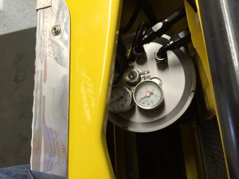

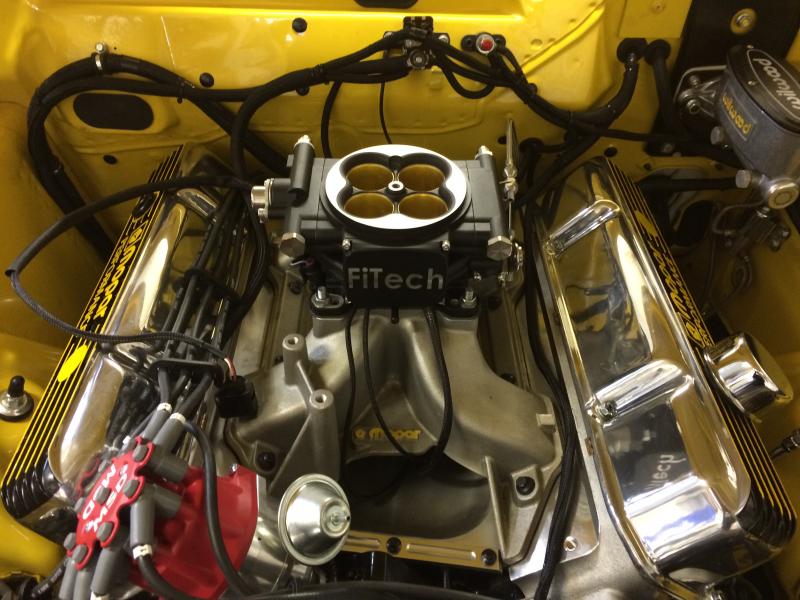

I'm not sure how insulated the FCC is.Looks great & impressive! Ive been researching the fitech/fast/ msd just to compare so if the day ever comes I decide to go that way... I kind of like the fcc, but like others have said here it is kids scary having a gallon of fuel under the hood... But I wanted to ask you are the fccs insulated in anyway? Seems to me that would beneficial since its under the hood....or even if it was double walled....
Awesome job thanks for all of the updates!

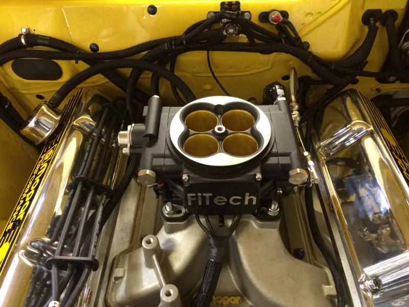

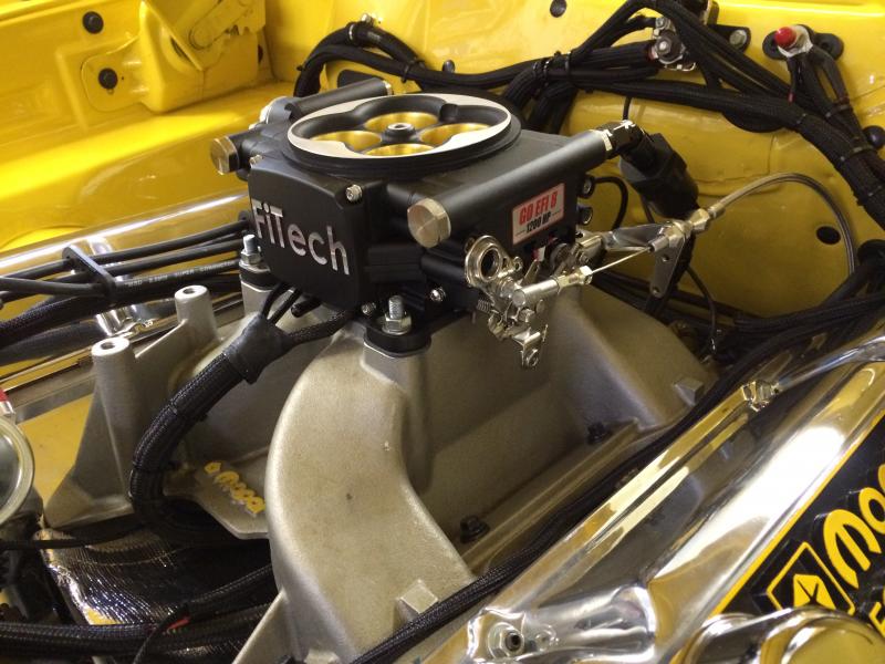

One thing I must add: the FCC doesn't require a filter from the mechanical pump. I've been having some minor tuning issues so I re-read the instructions. I even had the passage highlighted and still installed a filter.
 Removed the filter today and inserted a 5/16" to 3/8" barbed adapter.
  Removed the filter today and inserted a 5/16" to 3/8" barbed adapter.Engine hasn't been idling right - lots of flat spots. Tonight I found the #2 spark plug wire laying on the header.
 After routing away the idle smoothed out.  I think ignition issues affect the EFI much more than carbureted.  The O2 sensor was probably going crazy trying to account for raw fuel dumping into the collector.
