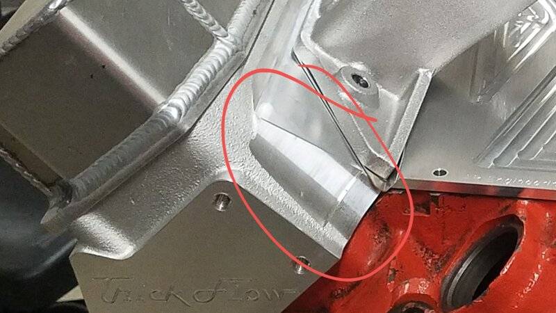

I'm not sure if this helps Bio....but these are 240s and they do come with a nice clearance area for the distributor. I believe the 270s do as well.
That said, I have no idea about where/how the one you're talking about might cause issues...
EXCELLENT! Not entirely what I was looking for, but an excellent contribution.
I certainly hope that by the time I get my setup I'm not the first to have the "killer combo" (IMO) of Progression Ignition and TF270s!
Also, I had NO IDEA that TF pre-clearanced that cylinder head. I would hope that the thickness of that area is something that TF can clearly convey to a customer.
