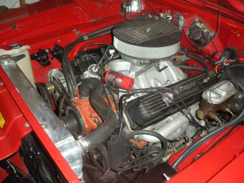

In the red car, I started out with the famous/infamous 292/509.
This was my first Mopar big block. I had experience with Chevy 350s prior to this but Mopar engines were new so I was learning as I went. I wasn't on any car forums so what I learned was from magazine articles and word of mouth chatter. Back in 2001, I hadn't heard about how common that cam and lifter failures were. I didn't know about oil quality. I barely knew about tuning an engine aside from parts replacement. I had the infamous Mopar Performance electronic ignition conversion including the distributor with that crazy long 28 degrees of mechanical advance. I didn't know about limiting advance to allow a lot of advance at idle (for better idle quality and more pep) without pushing 44 degrees at 2000 rpms. I chose the 509 cam because it was the biggest hydraulic that MP had and it was available at Summit Racing. The car idled rough, was sluggish off the line and detonated at higher rpms. The fix? replace the antique 509 cam with a new design!

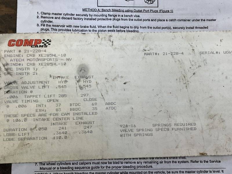

The Comp Cams XE285HL was a fast rate-of-lift design and high lift...
I used stock rocker arms with a .545 lift cam. Some will argue that I messed up there. I've read that the fast rate-of-lift cams are aggressive and are more prone to eating lifters. I don't know enough to say that is true or not. I don't think that I even thought about changing the valvesprings. Some people get on these forums and scream how Comp Cams are the worst. To that, I argue that since they have over 50% of the market of valvetrain products, they will have more failures but also more success stories. It is a simple numbers game. What really matters is the percentage of failures. Maybe they have a lower or higher rate of failures? Who knows? Nobody that I know of has compiled all the data to do a study and nobody ever will.
In retrospect, those cams of mine were destined to fail and not because of any defect in manufacturing.

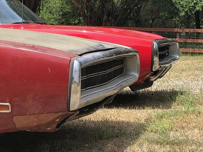

I currently have 5 classic vehicles out back with flat tappet cams. These two cars are build a bit hotter than stock:
To add, I also have a 67 Dart with a 360, a 72 Duster with a 360 and the 75 Power Wagon with a 440. I have not used any special oil in these three and have seen no failures.

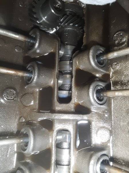

The worst issue I had was the lifter bores not being in the correct spots. It caused edge chipping on the tappets (solid), which I caught early as I lost the tip of that pushrod. I had a Hughes cam and kit so I called and spoke to Dave and he recommended I send him the cam for diagnoses. As he told me the misalignment of bores was my problem. With the mild OEM cam specs the system worked for years but, the higher lift and duration cam brought out the issue of alignment. I had the bores brass bushed (with a small slot for oiling-in case a lifter left the bore) and machined the bushings to correct positions. Problem solved.
Hughes related that as the BB engine production neared the end, the machinery used to bore the lifter holes probably got worn and wasn't replaced, due to costs, resulting in less than optimal dimensions
