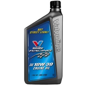

My vote, hydraulic flat tappet.. I mean come on, you are only running a .500 lift camshaft!? It isn't like you are straining out the valve train with a huge solid.. Valve spring pressures can stay low, and your camshaft life high. I use edelbrock zinc treatment. I also run VR1 racing oil. Proper break-in is key to camshaft life, as well as frequent oil changes with quality 'flat tappet approved' zinc enhanced motor oil.
