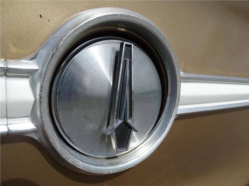

On a couple occasions I've had to keep a close eye on my gas cap. I'm not keen on changing the design of the side mldg but just wondering if a flip cap can be installed within the Belvedere trim without altering the trim. Can't find dimensions for the flip cap. Thanks

I don't think you can do it with the existing trim.
Nice cap though...I'd like one for my car.
Had one on my 66 Satellite didn't have that large trim ring, leaked like a pig. Get an extra piece of chrome and cut the new piece to fit 67 GTX chrome trim ring. Keep your original piece so if you change your mind.
I have another trim piece and was planning to take some measurements to see if it would work and how it will look. Hoping to get flip cap dimensions before destroying the trim. Next step, buy the flip cap. Will post the results.
Buy the trim ring. Trim ring goes on before cap. Not posative why mine leaked but wrecked the paint on quarter. Accelerate hard and gas comes up fill tube, if cap doesn't seal out it comes.
You will have to cut that trim.
The order of parts for a flip cap install:
Remove screws holding pipe to quarter panel
Install spacer bracket
Install rubber spacer
Put on trim ring and cap and install screws through to spacer bracket
The rubber spacer seals against the trim ring and holds it tight to the filler neck. The trim ring wouldn’t be needed with your Belvedere trim, but then you are missing the thickness of the ring which holds the rubber spacer in place and it will cause a leak.

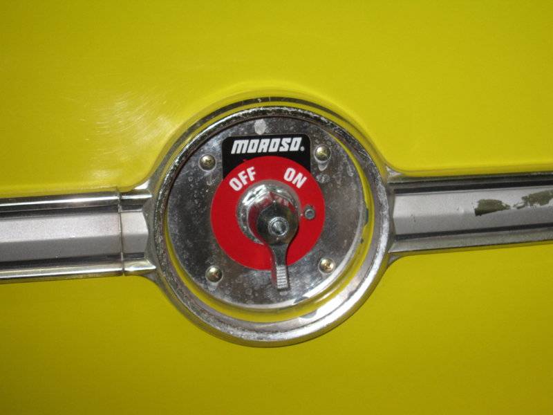

Since I put a cell in my floor I used the former filler hole for this:

Photos would be appreciated. I have a separate piece of trim (to cut) and bought a '67 GTX cap. Will see what happens. Thanks.
Hope you bought the trim ring? It should let cap seat/seal filler. As always MO, your car,:D Good luck whatever you do. Picture before, during and after, please.

The GTX cap is actually the "cheap" option to solve the theft problem.
I agree, the trim ring is an integral part of the assembly and it won't seal without it
(You'll also need that secondary rubber seal)
I believe Megaparts sells the parts separately, including the seal and trim ring.
