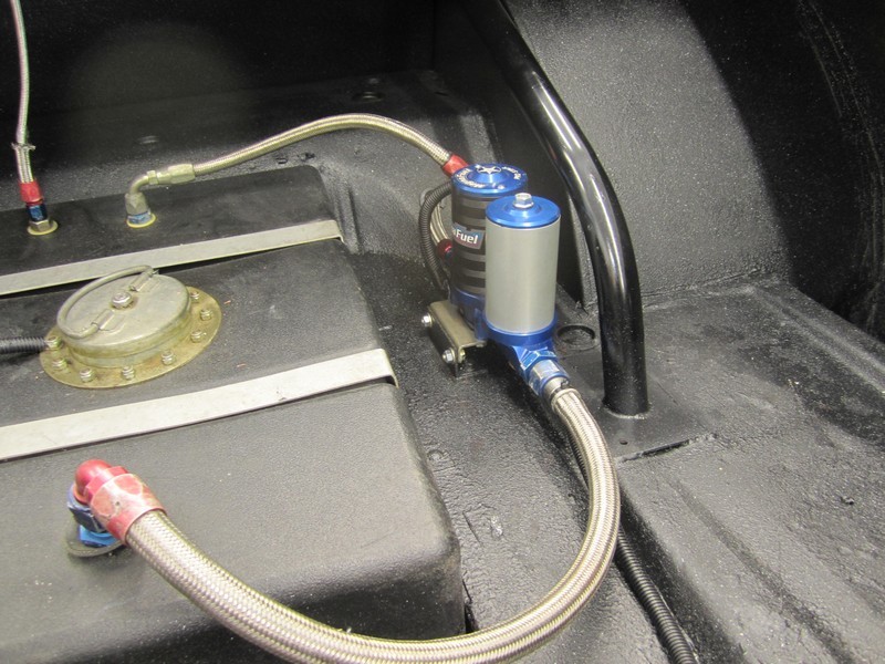

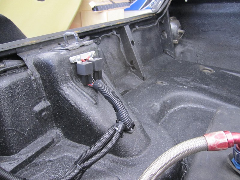

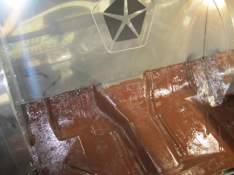

I used rustolium on the floors and splatter paint in the trunk:happy5:
