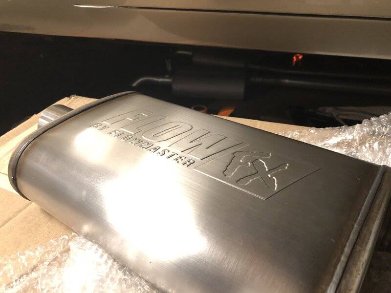

Anyone running the FlowFX mufflers.?? And are you happy with the sound and it's level? Gotta do something with this noisy brown turd before we go deaf, with it's no name copies of I suspect Flowmaster 40's at the noisy end of Holley's decibel scale.

im using the flowFx’s
switched from the FM 40’s
sounds very punchy without any drone or large metal sound

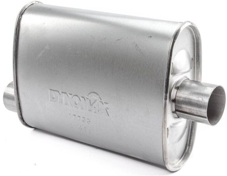

Thanks! The 14" Dynomax Super Turbo?? #DYN17734 ???

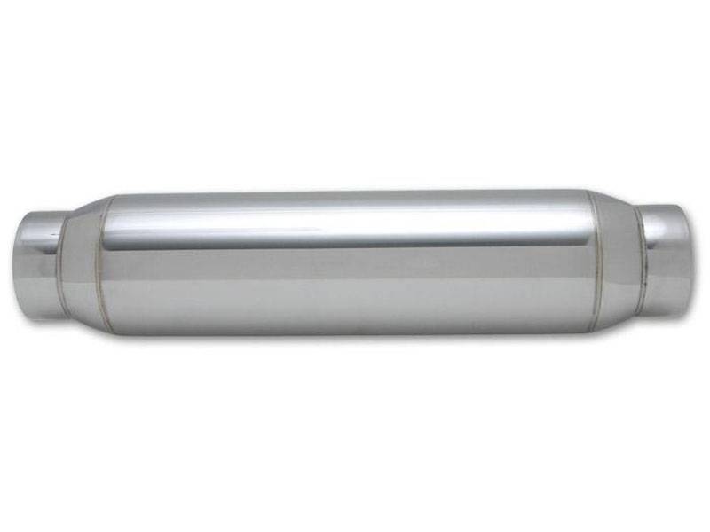

Is adding resonators an option? Would be much cheaper than buying two new mufflers and would quiet down your exhaust note considerably, if that's what you want.
I got some put on after the mufflers on my 64 Newport and they are amazing! Still has a mean tone but it is not what I would call loud. No drone at all in the cabin.

Ordered a pair of Dynomax 17733 Super Turbo's off of Amazon for $120 all in. Free shipping to boot vs $52 shipping if I wanted them a day earlier! LOL. I'll see how they work out when I get time to install them.
