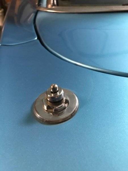

Looking for a good option for a retractable, non-power antenna for my '67 Satellite that will go totally flush. The antenna has become a huge annoyance when I put on the car cover. Any aftermarket antennas you guys recommend?
I was able to use this one (chrome) and use all the above fender parts to look original.
I was unable to adapt the under fender mount, but silicone under the base holds it very tight.
Did you silicone the chrome ring directly to the fender? I have replicated what you have on top, just trying to figure out how to hold it on securely to the fender. Thanks for the help.
